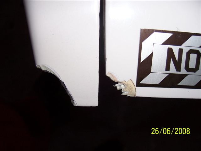

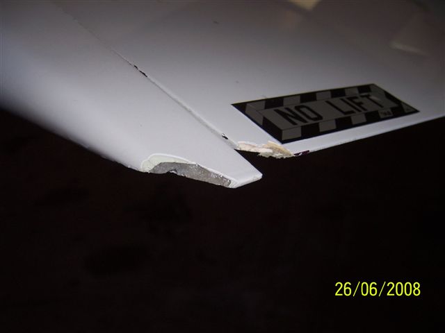

Three years ago during a hard sidewind landing my
port side wing´s and aileron´s trailing edge
corner hit ground and they got a small damage.
There was not any problems when fixing it.
