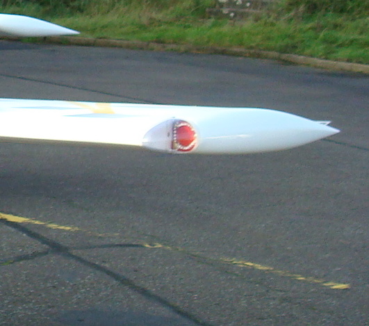

I got mine from Fred Klein some years ago. He only made
a batch of I think 20 or so. best give him a call. pic attached.
Cheers Danny ( G-c.e.r.i.

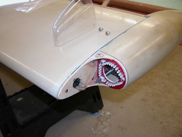

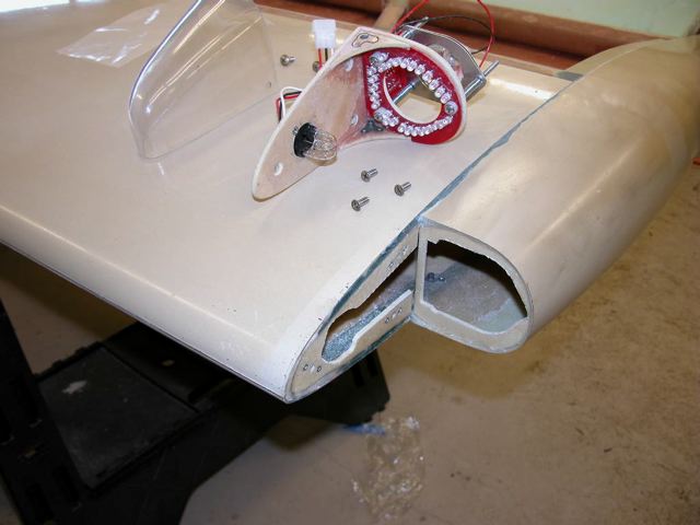

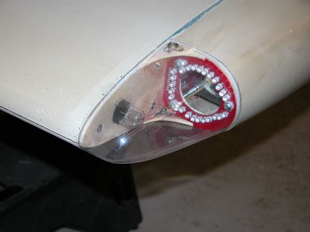

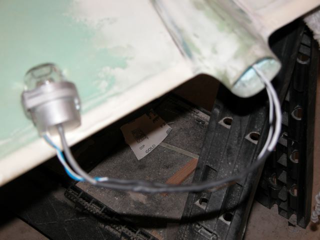

Check this out:
http://www.matronics.com/photoshare/fklein(at)orcasonline.com.11.26.2004/
Pixs below show my LED position, strobe, and Halogen land'g lite combos using the polycarbonate covers.
Fred
[img]cid:CC268AFB-20CE-4372-B6D1-930C371E7255[/img]
[img]cid:3259FE4F-444D-4882-BF3E-8C5ECAE928BF[/img]
[img]cid:BA8C4F93-1934-47F0-BD3C-BCBC14584634[/img]
[img]cid:6BE8C500-6B21-426B-86D9-A1BC499E513C[/img]
