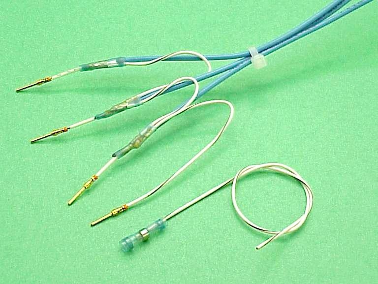

PostPosted: Sun Sep 18, 2011 8:41 am    Post subject: Two wires in one d-sub pin Reply with quote
Another solution would be to use a solder sleeve. They come in a variety of sizes. You can get them from SteinAir, ACS, and a variety of other places.

PostPosted: Mon Sep 19, 2011 4:46 pm    Post subject: Two wires in one d-sub pin Reply with quote
[img]cid:7.1.0.9.0.20110918123209.044e0820(at)aeroelectric.com.1[/img]
Agreed. In fact it's preferable. Here's another
approach.
[img]cid:7.1.0.9.0.20110918123209.044e0820(at)aeroelectric.com.2[/img]
This technique is pretty much standard practice
in the TC aircraft industry. See:
http://www.aeroelectric.com/articles/pigtail/pigtail.html
