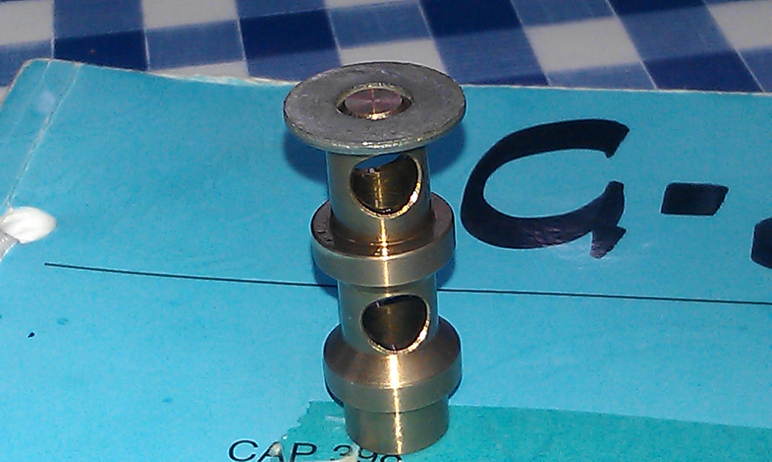

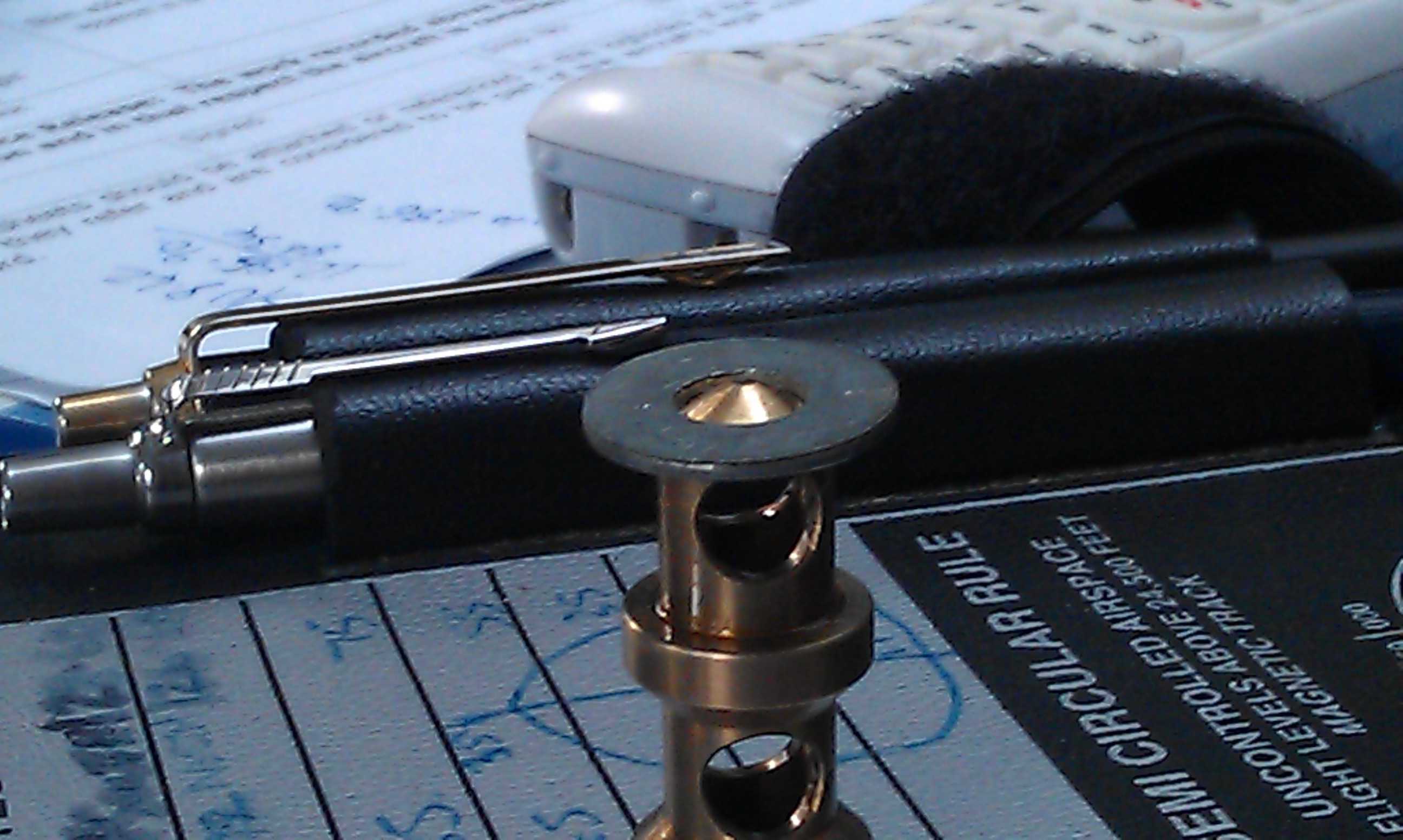

3300 with Hydraulic lifter with relief valve plug shaped to a point, engine 1460 again, compare this to the previous video, look at the sweep of the valve needle.
http://www.youtube.com/watch?v=bnRlyl20HaY
See here for still photos of the valve tip, this was simply done with the valve in a drill chuck and a needle file.
http://groups.yahoo.com/group/jabiruengines/photos/album/439839736/pic/list
A couple at attached for the Matronics listers.
<<pointed relief valve plug.jpg>> <<standard shape relief valve plug.jpg>>

The pulse on my 3300 is a drop of 20 psi where the valve lifts and then it re-seats allowing the pressure to build again. I could see this when turning the prop by hand.
