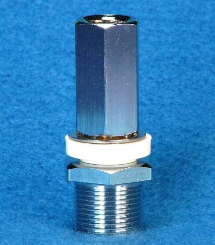

On several occasions I've cited a commonly
marketed insulated feed-thru mounting for CB
antennas as suitable for doing your own
comm antenna. I've seen this part in blister
packs in lots of stores for prices ranging from
8 to 12 dollars.
Here's an offering I just spotted on Ebay
http://tinyurl.com/3bq5uhv
[img]cid:.0[/img]
The price is right.
You can put a UHF connector on your feedline and
it will connect directly to this mounting. Alternatively,
a UHF-M/BNC-F adapter will let you use the more
common BNC-CM connector on your coax.

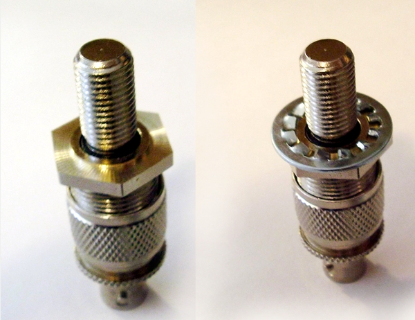

An improved methodology for keeping the lockwasher centered
on the connector is to cut away .015 to .020" of material
off the face of the hex down to a diameter of .500" as shown
here. You can grip the part in a 3-jaw chuck directly onto the
threads. Don't mash 'em and take very light cuts. A couple of
.005" passes produced this end result with no damage to threads.
[img]cid:.1[/img]

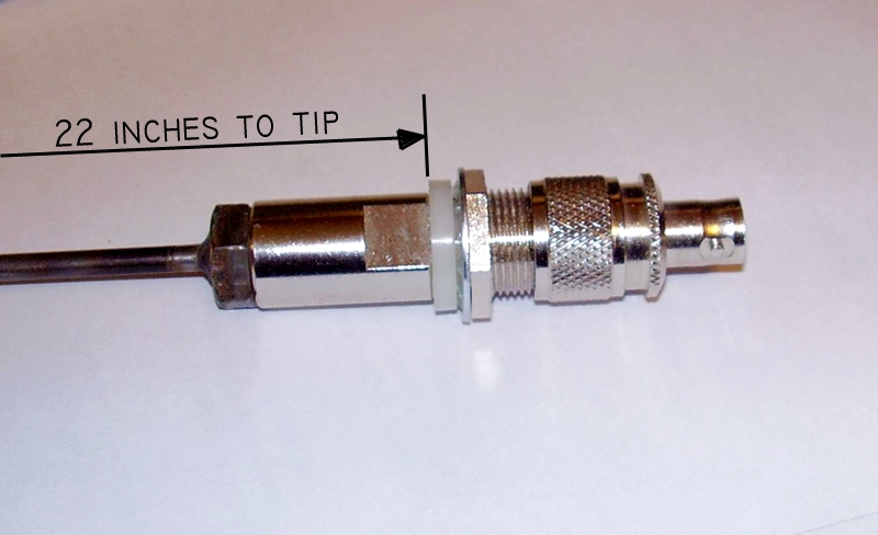

This modification of the base will keep the lockwasher centered
while you bolt everything up. After all is said and done, here's
what your ready-to-install antenna looks like.
[img]cid:.2[/img]
8 to 12 dollars.
Here's an offering I spotted on Ebay
[img]cid:7.1.0.9.0.20110917114941.044e8cc0(at)aeroelectric.com.4[/img]
The price is right.
You can put a UHF connector on your feed line and
a UHF-M/BNC-F adapter will let you use the user friendly
[img]cid:7.1.0.9.0.20110917114941.044e8cc0(at)aeroelectric.com.5[/img]
[img]cid:7.1.0.9.0.20110917114941.044e8cc0(at)aeroelectric.com.6[/img]
