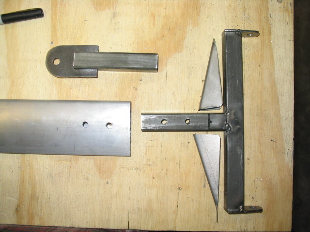

I have an interest in converting my FireFly (Five-Charlie_Bravo) to a single liftstrut like the FlagFly.
I believe I recall a post to the List when the FlagFly was converted, but am unable to locate it in the archives.
Any help would be appreciated...

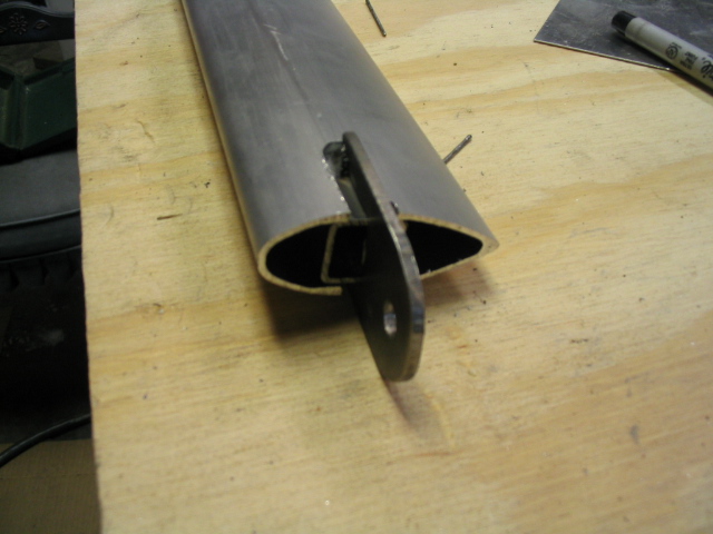

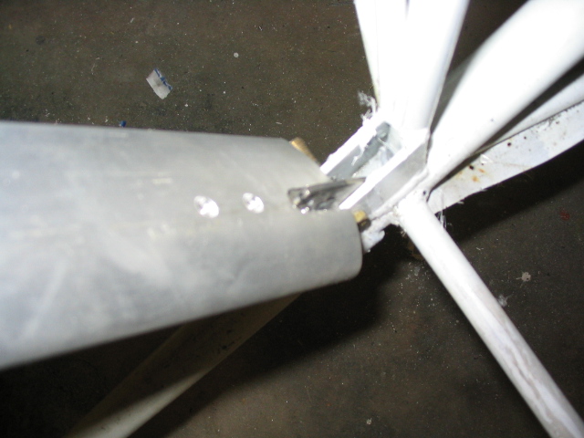

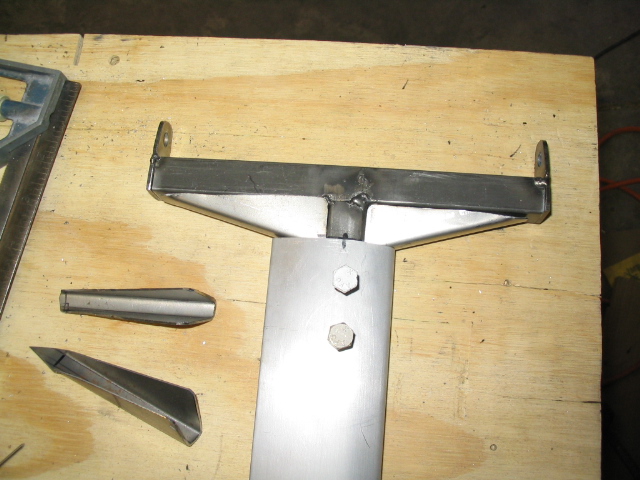

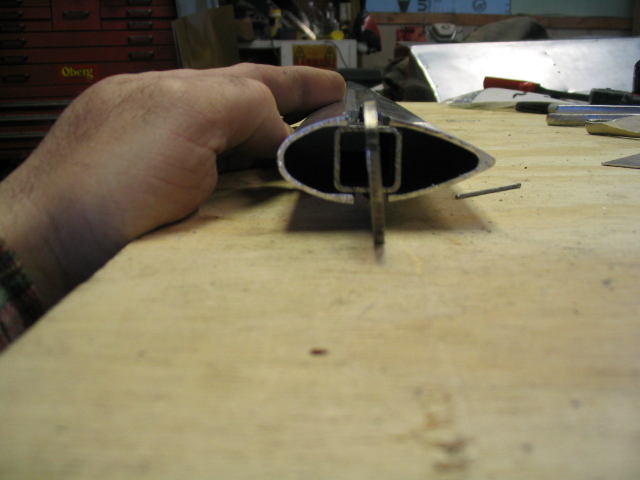

Henry,
I am afraid about all I can offer is these photos, as the details of the strut mod has escaped my memory. I cant believe it has been almost 9 years since I began that firefly..Oct 2002...whew! I can tell you I remember discussing it with Dennis Souder to get any tips, and what it might do to the performance. Also his verification that the reason the firefly had the 2 strut design was to increase drag..to help get past the FAA's requirements and meet part 103 according to some formula they use. Anyway..it made a huge difference in speed. After consulting with Dennis..I realized what potential that craft has, and I decided to enclose the rear cage also..and undertake various other drag reduction mods an so on..it raised the top speed of that craft so much no one would believe it , so I didnt brag on it much for fear of the disbelief it would bring anyway.
I will mention this, should you proceed with this project, it is very critical to get the airframe in the "in flight attitude" and align the struts with the airflow/airstream..NOT the airframe...for maximum relief from drag. if you dont, those streamline struts will act like flaps...which they do BTW in slow speed nose up attitudes.

Thanks for the information and photos... You did a beautiful job on those struts.
Too bad about Geocities expiring... I recall going there to read your posting.
I am assuming that the aerodynamic struts are aluminum and the steel is 4130...
I was able to find some other postings on the subject in the archives. But your photos are the best.
Haven't welding long, so I'm not sure I'll trust liftstruts (somewhat flight critical) to my hand...
