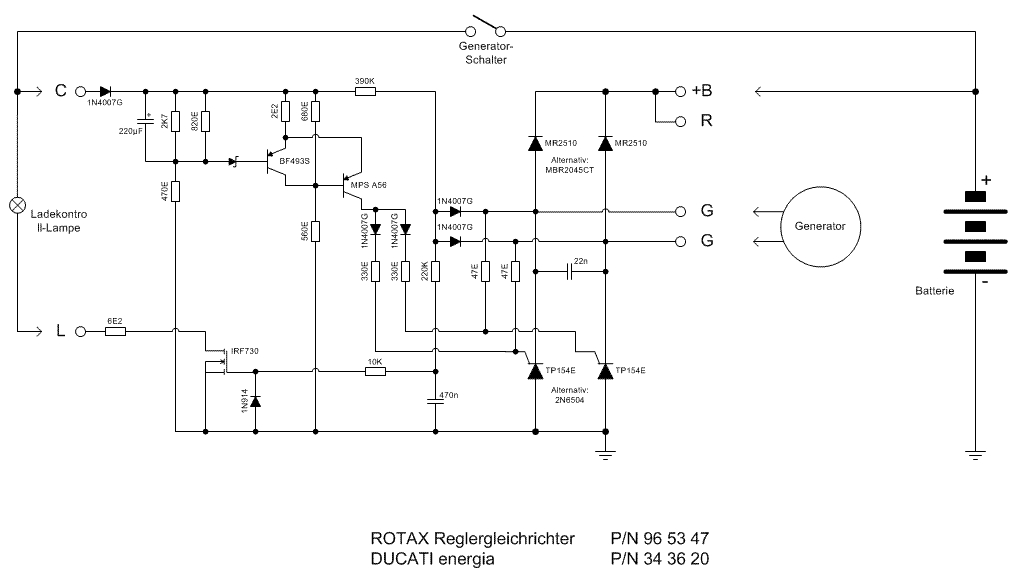

PostPosted: Tue Sep 13, 2011 7:11 am    Post subject: Rotax 912ULS charging problem Reply with quote
Another schematic attached - also without correctness guarantee.
Jan de Jong
 Filesize:  77.5 KB
 Viewed:  9100 Time(s)
n992dn(at)gmail.com
PostPosted: Tue Sep 13, 2011 10:22 am    Post subject: Rotax 912ULS charging problem Reply with quote
Jan
Thanks so much, I think the diagram you provided is  accurate, the replacement part number for the SCR (2N6504) help verifying that these are SCR'S. by looking at your diagram I was able to understand the principal of operation of the charger. The two SCRs are used to connect to ground each one of the G terminals during its negative part of the cycle making it referenced to ground so the other G terminal can charge the battery thru the in line diode. (the G leads coming from the engine are not referenced to ground otherwise).
With regards to my charging problem, the way I read the diagram is the charge light on/off control is related only to the existing of AC energy between the two G terminals, not to anything else, it’s a bit surprising. My understanding of the charge light logic did not help me at all to Identify the source of the incorrect  indication problem I am facing with.
Bob,
I suggest that you replace the diagram  currently published on your web site with the one Jan has provided
Thanks and regards
Nati
On Tue, Sep 13, 2011 at 10:07 AM, Jan de Jong <jan_de_jong(at)casema.nl (jan_de_jong(at)casema.nl)> wrote:
[quote]Another schematic attached - also without correctness guarantee.
Jan de Jong
PostPosted: Tue Sep 13, 2011 6:20 pm    Post subject: Rotax 912ULS charging problem Reply with quote
Bob,
Thanks and regards
Nati
Good idea sir. I'll do it right now.
