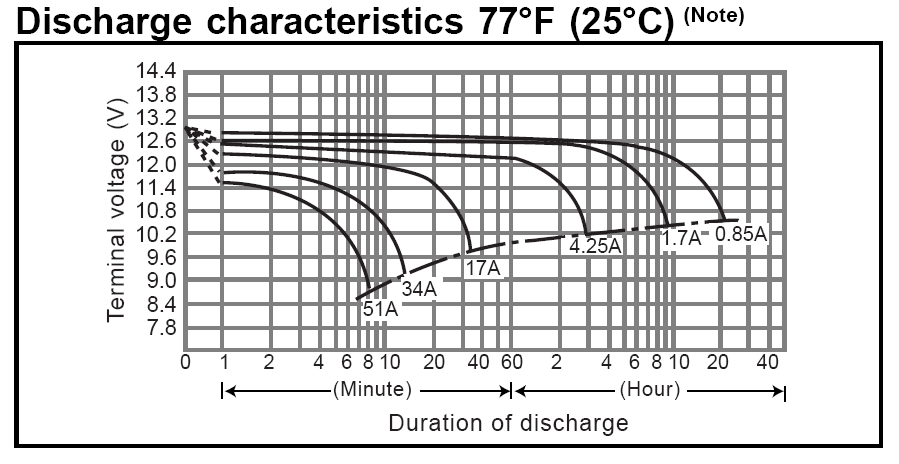

A battery's ability to deliver energy depends
on size, condition, temperature and load. A
battery 'rated' at 20AH will deliver that amount
of output when new and generally under a very
light load compared to how you intend to used it.
Consider the exemplar plot below
[img]cid:.0[/img]
This battery is 'rated' at 17 a.h. But it will
deliver that output only when loaded at .85A x
20 hours = 17 a.h. Your airplane's endurance
loads are more likely to be on the order of 4A
so you can expect about 3 hours of service or
12.75 a.h. of output. Of course, this is an as-new
performance value. You'll want to size and maintain
your battery to meed design goals when the battery
has just degraded to the point of needing replacement.
For most folks this is at 75 or 80% of new capacity.
So this particular battery could be used in a system
where endurance expectations are for 2 hours of
service at 4.25A.
The battery cap tester depicted in the book is
not intended to give you an accurate reading of
the battery's capacity. What it will do is let
you know when the battery has fallen so far below
its as-new condition as to require replacement.
If your new battery ran your exemplar load for say
200 minutes, then you would benchmark the replacement
at 150 minutes.

Keep in mind that this is more of a battery
bench-marker as opposed to a quantitative
tester.
service at 4.25A.
at 150 minutes.
