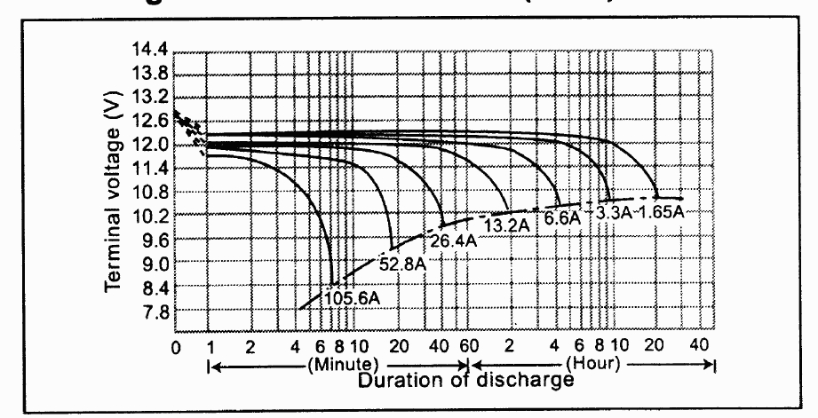

Actually, a "standard" 35 series battery, as used in many certified planes with battery in the tail cone is only 29 amp hours(CB35A or RG35A) or less. The battery that I recall Vans recommending is either 22 or 24 amp hours (RG25 or RG25XC).
Ampere hour ratings of batteries can be exceedingly
short on useful information. A battery's internal
resistance can have a profound effect on DELIVERED
energy. Here is an exemplar energy delivery plot on
a 33 a.h. RG battery:
[img]cid:7.1.0.9.0.20110906194510.01dcdb28(at)aeroelectric.com.0[/img]
Note that it will deliver 33 a.h. at a 20 hour discharge cycle
loaded at only 1.65 amps. When loaded with say, 6.6A of endurance
loads, you get just over 4 hours or 26 a.h. Load it heavier to like
53 amps an the critter tosses in the towel in 20 minutes or 1/3 hour
for a 'rating' of about 17 a.h.
A flooded battery would not do as well as this AGM example.
So there are TWO characteristics you're interested in for
assessing a battery's flight worthiness:
Delivery at heavy loads for cranking and delivery at moderate
loads for alternator-out endurance. But any notions that
paralleling a couple of batteries will combine for a 'name
plate rated' level of performance is kind of wishful thinking.
