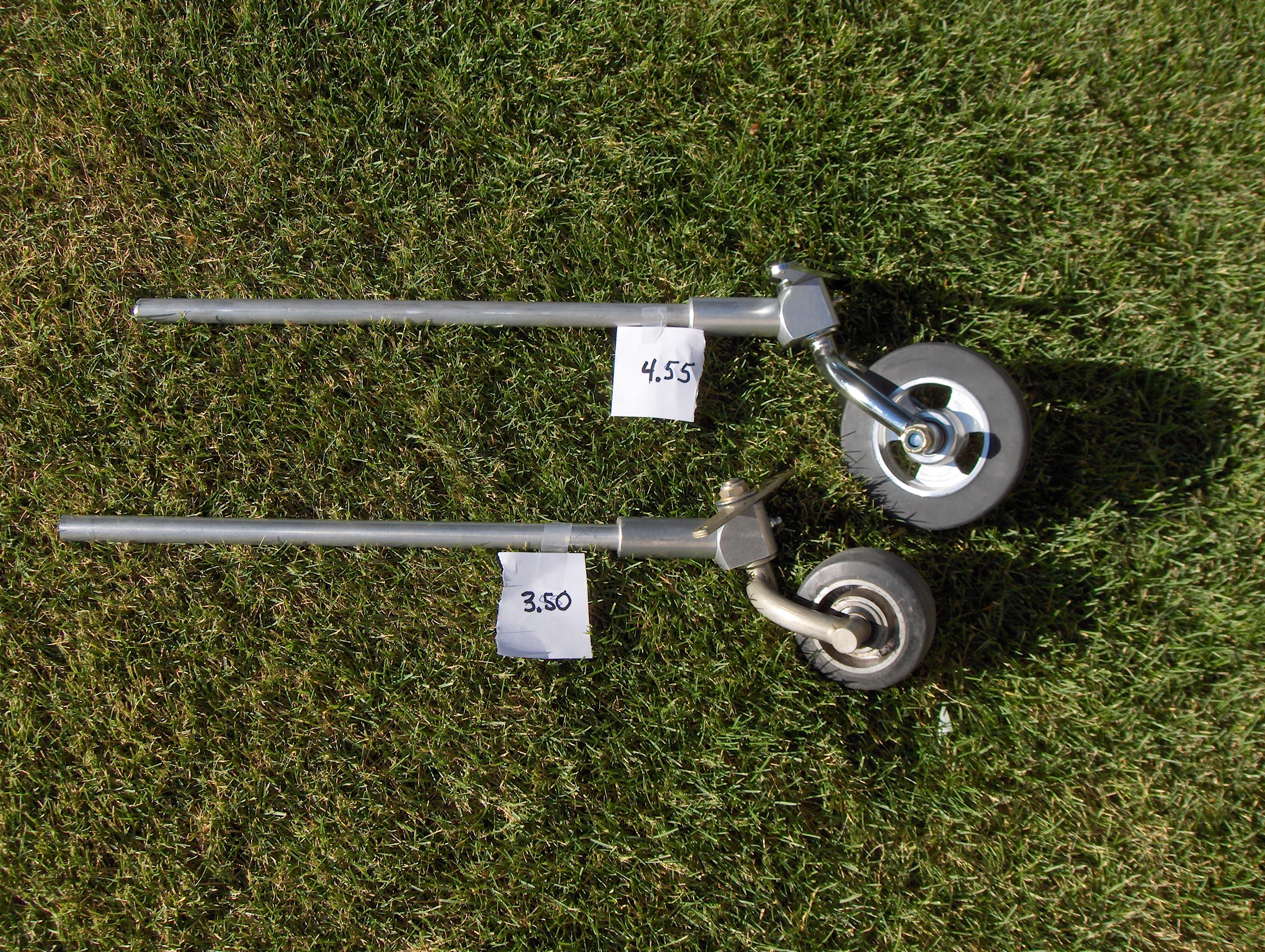

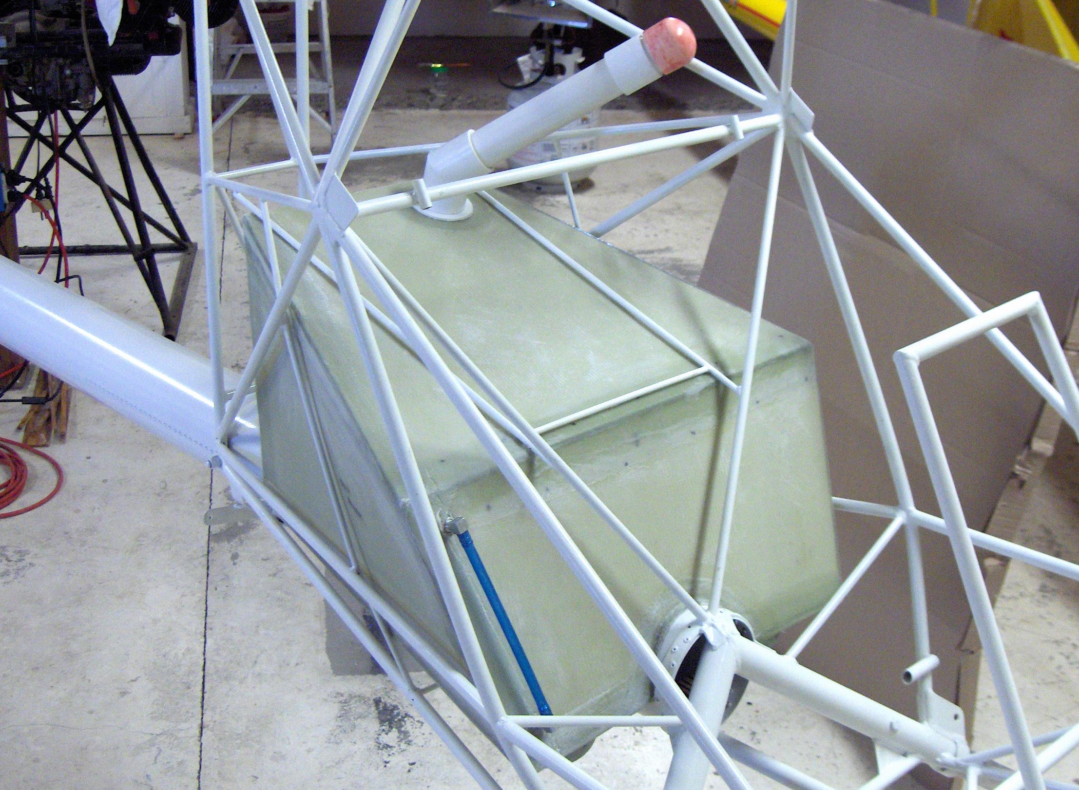

Jimmy, I am building a Firestar II with an HKS engine. Am concerned about
weight and balance. I weigh 170 lbs. I am installing a 4.5 lb., 6 inch
tail wheel . Have a 15 gallon integrated fuel tank so I may have an aft cg
problem. What size battery did you use and is your solenoid close to the
battery? Do you have a starter solenoid as well continuous operation
solenoid? Attached are two pictures of project.

Andy, I don't remember the size of the battery, but it's a typical motorcycle battery. I do have both a continuous-duty solenoid located behind my seat at my elect. service panel and a starter solenoid that came with the engine. I have a custom tailwheel I built that is heavier than the stock TW, but again I don't know what it weighs.
I assume the original builder of my Kolb may have been a lighter weight fellow & been concerned with the same W&B issues you have, and thus the nosecone battery location. I wish I weighed 170, but am more like 225.
You may want to consider adding the tailwheel struts others have done on the Kolbs. My lower vert. stblzr. assembly broke due to the side loads and the struts really help it out. Do an archive search & you will find them.
