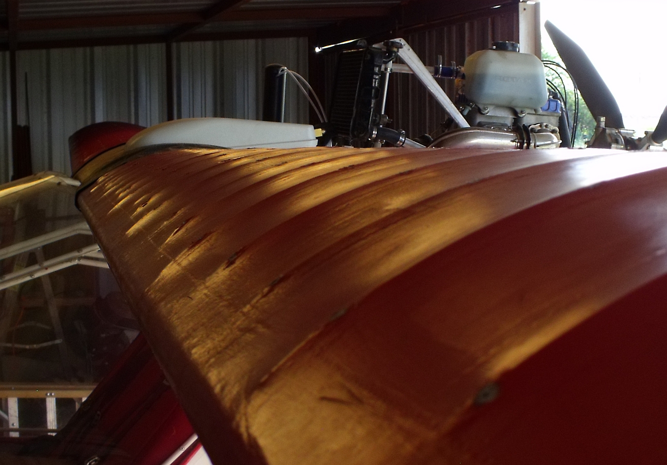

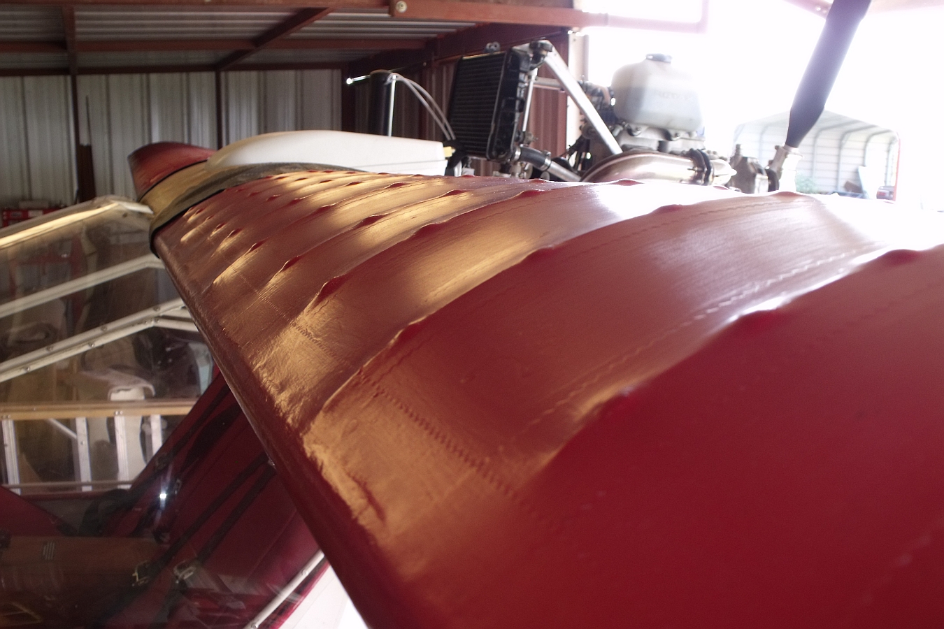

As I told Ken last night, for the first time I was able to enjoy flying his plane. As you can see by the pictures the original builder (OB) put rivets on the camber of the ribs. 300+ rivets. It was a job removing them, repairing the tapes around the area, and patching the holes caused when the drill spun off as the head. I still have to put on new tapes on, but last night the weather was so nice I just couldn't wait. At first I was disappointed, there was still some pressure on the stick during climbout, but not as much, and for the first time I could feel a real difference when I pulled on more trim. At any rate, it felt good enough that I decided  to climb up to 3000' AGL and try some stalls. It was when I pulled the power back the pressure on the stick lessened. I put off stall testing to investigate and found that at 4700 rpm the Mk IIIX would fly straight and level hands off. At 4000 rpm and below there was back pressure on the stick, i.e. I had to push forward on it.

Glad you are making progress. After all the efforts to fix the lawn dart tendency, can you tell us which one or combination of fixes (OB errors) resulted in the big advance? I don't doubt you mentioned it before but I just don't remember which of the problem resolutions was the big one.

Thom, I think the top two were resetting the angle of incidence of the wings and removing the rivets.One other project that needs to be done is to add some stiffening ribs to the upper, inside surface of the nose cone. Next time I fly I'll try to get a good picture of just how much it caves in. I've told Ken that if it were my airplane I would make a new nose that would be shorter and more rounded, especially on the sides.
