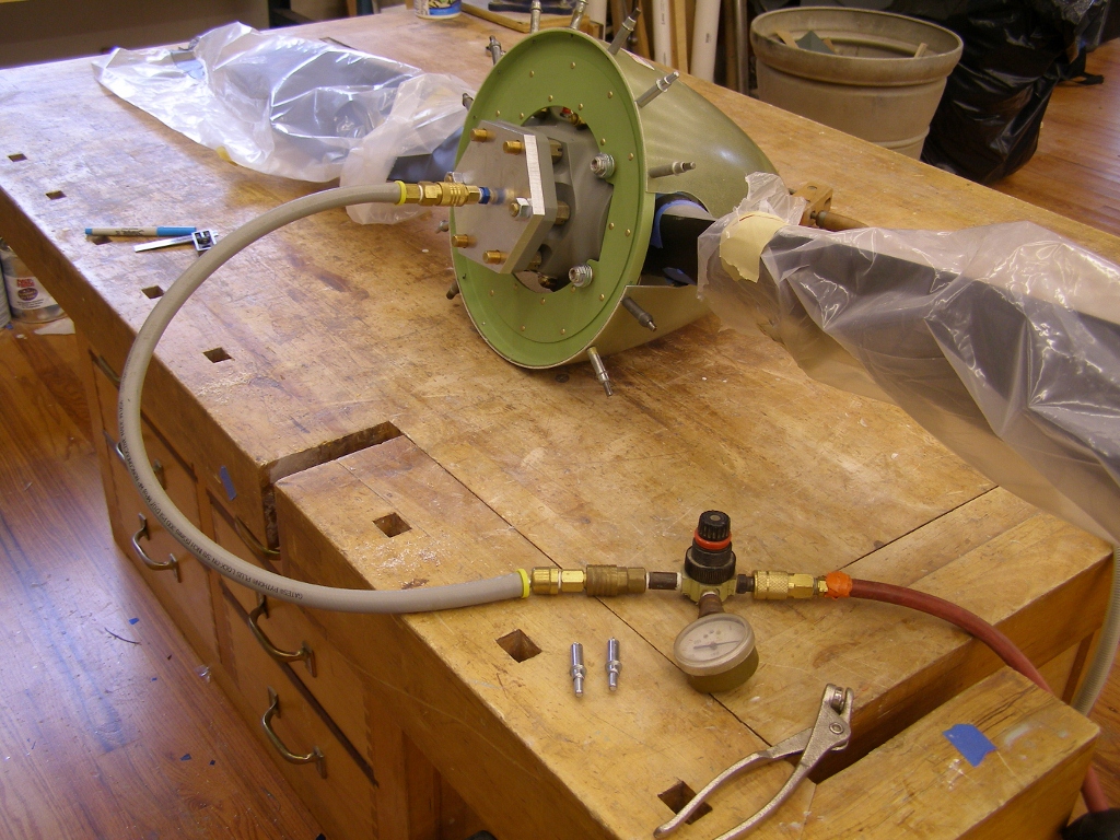

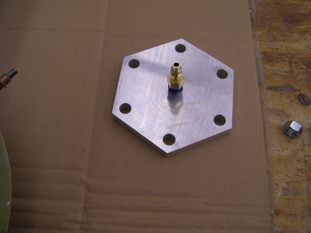

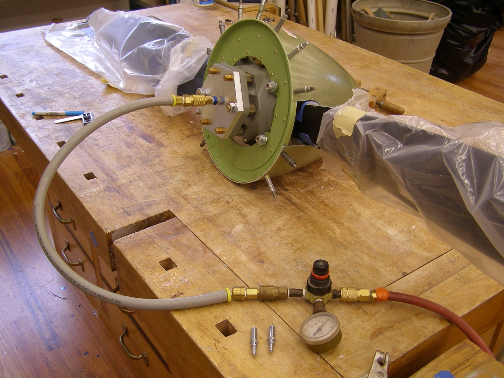

Two items to share: Working on the spinner fit this weekend and was wondering how to do the cut-outs for the prop blades so as to account for the fine and course pitch setting. Didn’t see anything useful in the plans, just a note to ensure to leave room when making the cut-out. The blades move via oil pressure from the governor, so why not a little air pressure, seems like it should work. Well sure enough, only about 25 psi does the trick and the blades go to full course pitch. So I machined up a nice adapter plate to get the job done. See attached photos. I’m going to make this adapter plate available to the RV-10 list folks on the loaner program. I’ll be done with it after this weekend and will ship it to whomever needs it next, I just ask that you pay for shipping.

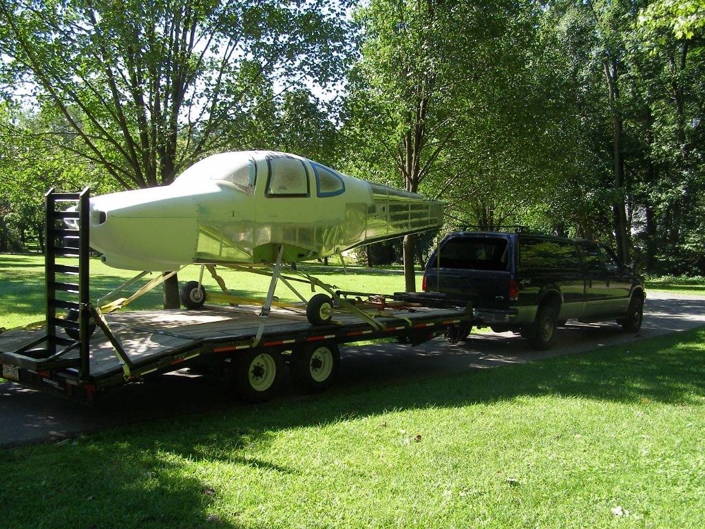

On a second topic, Monday was a big day here, after almost 8 years of super slow building I’m running out of parts! N541RV has moved to the paint shop! Lancaster Aero Refinshers in Smoketown PA now has my plane [img]cid:159E999E758E48518895F5393E331025(at)Boblaptop[/img].   The paint scheme is agreed to and the test panel of paint have been shot.

That is handy when you are alone. The wife and I used two
wood clamps with a rag protecting the paint. Worked like a charm.
There is around 325 psi gov oil pres in normal operation so those aerodynamic loads are powerful. Nice to know information and nice tool. Thanks.
