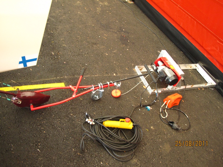

PostPosted: Tue Aug 30, 2011 8:27 am    Post subject: Electric winch or hand crank? Reply with quote
Hi Martin
Attached is my solution (how to pull my Mono to
the hanger which locates on the small hill).
As you can see, I trust to my tailwheel.
Max pull force which is needed when pulling it
into hanger is 40 kg which is not a problem for a
sturdy structure of Europa´s tail wheel.
The winch itself is actually an engine hoist which
should be mounted to the roof.
It is capable enough to pull/lift 150 kgs = 330
lbs.
I did an adapter and bolted the hoist via adapter
to the ground /asphalt.
Remote controller is wired (a long cable, 12
metres /36 feet so I can well check all the
clearances when pulling her).
There are two limit switches so it is safe to use.
It would be easy to make it wireless controlled
but that is not necessary in my case.
When using it I feel myself to be more an operator
than a labour-pull-man.
If I were you, I would watch ATV (All Terrain
Vehicle) winches. Some of them are very strong and
operates straight with 12 VDC.
So it is easy to install into to the trailer.
Cheers, Raimo Toivio

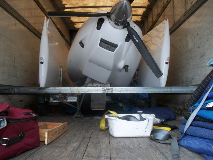

My fabricator makes from 1/2 to 3/4 inch nylon a set of tapered spacers that drop in the carrier and hold the tire very snug to prevent side to side leaning. The wheel bearings and wheel are very strong so I expect it to hold the aircraft. A six ply sidewall on a 7 inch tire flexes very little. Only a small amount of taper is required to get the tire wedged in. Then the trailer ramp/arm is raised to hold the gear channel in position and if that is a bit loose, shims of phenolic were added to get a snug fit.
Here at Custom Flight we use ratchet straps to pull the gear leg into the trailer ramp hard and will modify the two adjustment arms if they do not bring the ramp up snug. Then we strap the wheel down hard to the trailer with crossed straps.
To prevent rocking back and forth if the tire loses pressure, we use bolts and a fake spar through the fuselage to hold the fuselage from leaning too far. Yes the wing will get in the way, so we run a strong strap from the trailers metal brace horizontally and hook down into those hooks. Miserable, tight and dirty to get between the fuselage and wing but doable. I have also seen folks use a strap over the fuselage, but I am not keen on that as the gear bounces so if you pull down tight, pad it well and check often.
Photo's attached of an aircraft that did not have the main wheel strapped:
[url=https://skydrive.live.com/redir.aspx?cid=2161856909618aa7&page=play&resid=2161856909618AA7!140&parid=2161856909618AA7!139&type=1&authkey=*AFq6nx20aM%24][img]cid:00c501cc680f$764abf30$00B69D56(at)goldfishbk2xxe[/img][/url]
Operator only strapped swing arm to trailer and aircraft bounced out.
