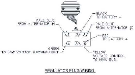

Hello:
I noticed my voltage regulator for my Jabiru 3300 has the red and yellow wires in different places than what the Jab schematic says. The schematic, taken from the Jabiru manual, says the top 3 wires in the plug are pale blue, black, and pale blue, in positions 1, 2 and 3 respectively. That agrees with my plug. But Jabiru says the bottom 3 wires are green (4), yellow (5), and red (6) whereas my voltage regulator has red in the #4 position, and green in the #6 position.
I'm assuming I should go by the colors of the wires, figuring they either mislabeled the schematic, or inserted the wrong wires in the plug. I have long since removed this plug and replaced it with fast on terminals. Pic of this with the schematic is attached.
Staying with the colors is a good bet . . . particularly
since the illustration of the connector does not state
whether it is a wire-side or mate-side view.
[img]cid:7.1.0.9.0.20110823142436.01dc8940(at)aeroelectric.com.0[/img]
[img]cid:7.1.0.9.0.20110823142436.01dc8940(at)aeroelectric.com.1[/img]
Unless there are pin numbers molded into the connector
body somewhere which conflict with the wiring diagram,
then the illustration is strongly suggestive of a mate-side
view . . . which agrees with the connector in the photo.
