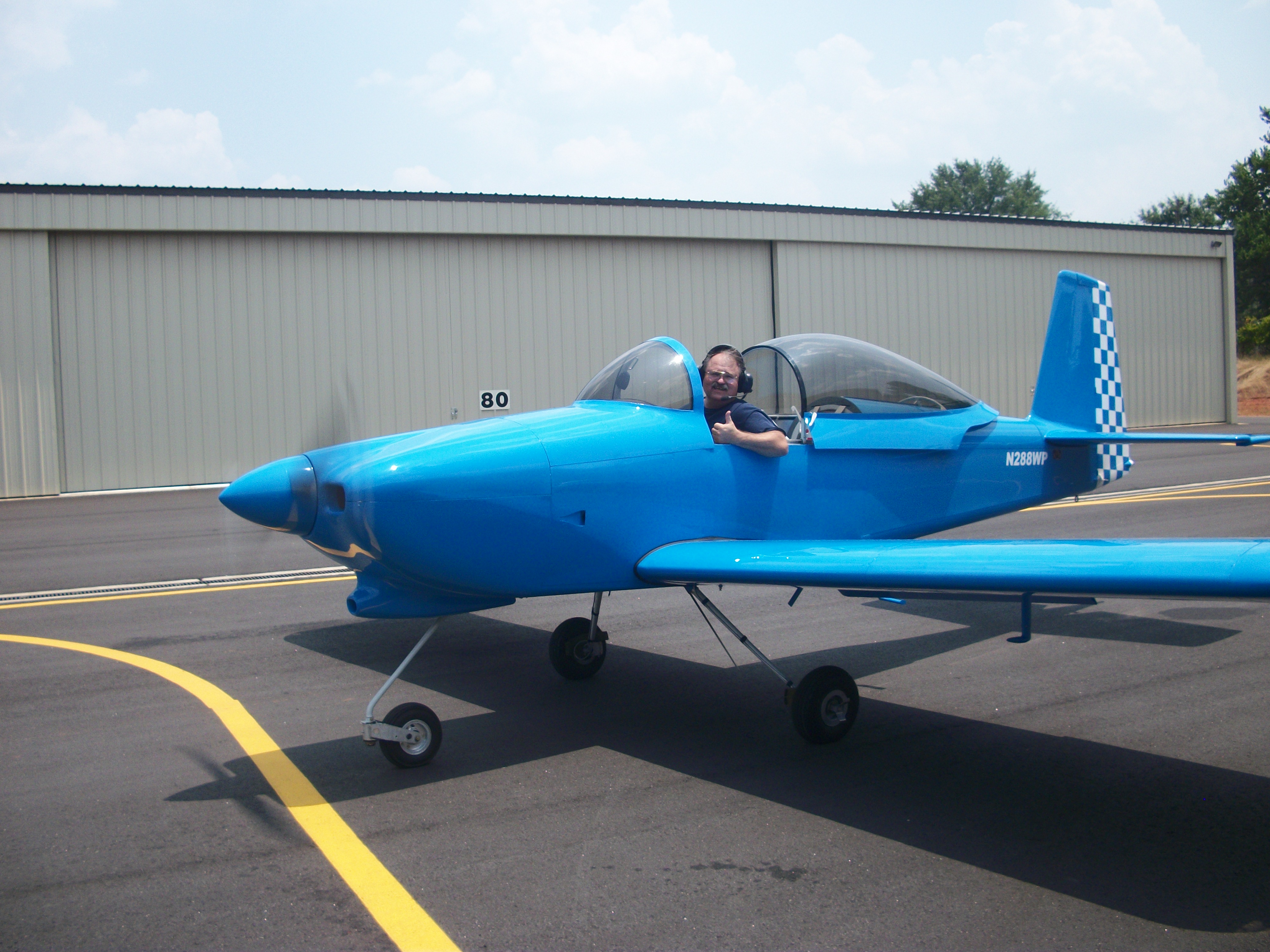

Dear Fellow Builders, I have a question. On the Drawings (C1 I think) Van shows the top on the front gear leg fairing reaching into the cowl all the way up to the engine mount, some 3-4 inches my guess. Looks like if I cut it off at the bottom of the cowl and fair it in with an intersection which I planned to use any how it would be a lot simpler. Both to build and to remove for service. Is it vital that the fairing passes through the bottom of the cowl? Went flying again today, got 16.6 hours total on the Blue Bird. A sweeter flying plane I have never flown, Hope to hear your opinion of the fairing and thanks, Bill of Georgia N288WP
