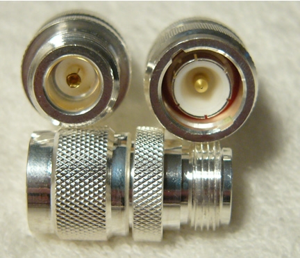

Here's an option:
[img]cid:7.1.0.9.0.20110818161613.01dce6a0(at)aeroelectric.com.0[/img]
This is a C-M to N-F adapter. If you've got the room
to stack this up inside the airplane. I can supply
you RG-142 with a N-CM connector and BNC on the
other end.
You can order the adapter at:
http://www.mgs4u.com/C-adapters.htm

grosseair(at)comcast.net
PostPosted: Thu Aug 18, 2011 2:46 pm    Post subject: Coax Connector Reply with quote
I was just going to post that I found that adapter as well. I was going
to combine it with a N-male to BNC-female adapter, but if you can put a
male-N on the end of a BNC/RG-142 cable that would eliminate one
connector and make for a little bit neater installation. How much and
how do I order it?
Thanks.
John

PostPosted: Thu Aug 18, 2011 6:47 pm    Post subject: Coax Connector Reply with quote
going to combine it with a N-male to BNC-female adapter, but if you
can put a male-N on the end of a BNC/RG-142 cable that would
eliminate one connector and make for a little bit neater
installation. How much and how do I order it?
Go to my website catalog at httP://aeroelectric.com
and fill in the order. Scroll down to the RG-142 cable
assemblies and enter "N-CM", length in feet and "BNC-CM"
in the boxes at the top of the form. Go down to the
bottom and hit 'submit'.
The cable will be $1.50/ft and no charge for the
connectors. Postage will be about $1.50
