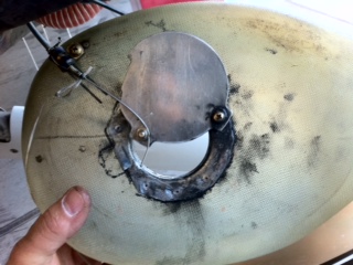

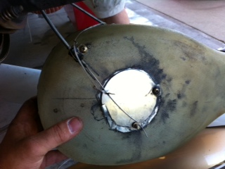

Taking things apart at annual. Noticed that alternate air doesn't seem to work right. Picture 2 shows it closed and under tab to keep it closed. Picture 1 shows it fully ?? open. BUT when you close it, it won't slide under tab for closing unless you have the tab loose, but then it closes, but stays open a little bit. Any suggestions?? thanks.

My recollection is that Van indicates in the FAB instructions that once the alternate air door is opened, it cannot be closed while in flight i.e. you must pull the cowl to get it fully closed.

Vans' instructions definitely say that once pulled, you have to drop the cowl and manually reset it to fully closed.
There are some production aircraft with "automatic" alternate air, as you describe. But i suspect alternate air is needed so seldom that the re-setting is just a once in a blue moon thing.
