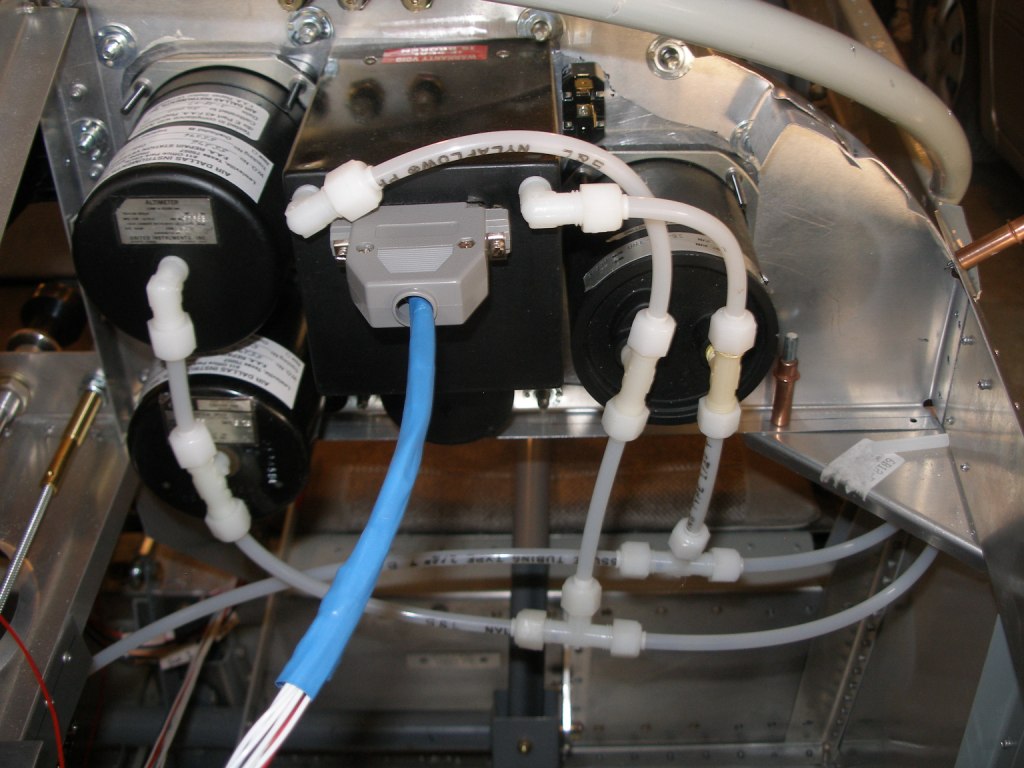

jaybannist(at)cs.com
PostPosted: Sun Aug 14, 2011 5:44 am    Post subject: Airspeed indicator and encoder fittings Reply with quote
Michel,
I used the screw type fittings. (see photo) My EAA tech adviser says he prefers the barb fittings, because they are less prone to leaking than the screw type, but they are a pain to re-do. The tubing must be cut off and replaced. I never had mine tested, so I can't say how tight they are.
Jay

PostPosted: Mon Aug 15, 2011 9:36 am    Post subject: Airspeed indicator and encoder fittings Reply with quote
Jay:
Nice clean instillation, but if I may make a suggestion:
On the two left gauges the hose coupling between the top & bottom is a failure point.  There is no length of hosing (service loop / pigtail) between the two so vibration is pulling and pushing between the two gauges.  Simple cure... Make a service loop/pig tail between the gauges.  This will give you room for service and eliminate stressing the connections & gauges.
