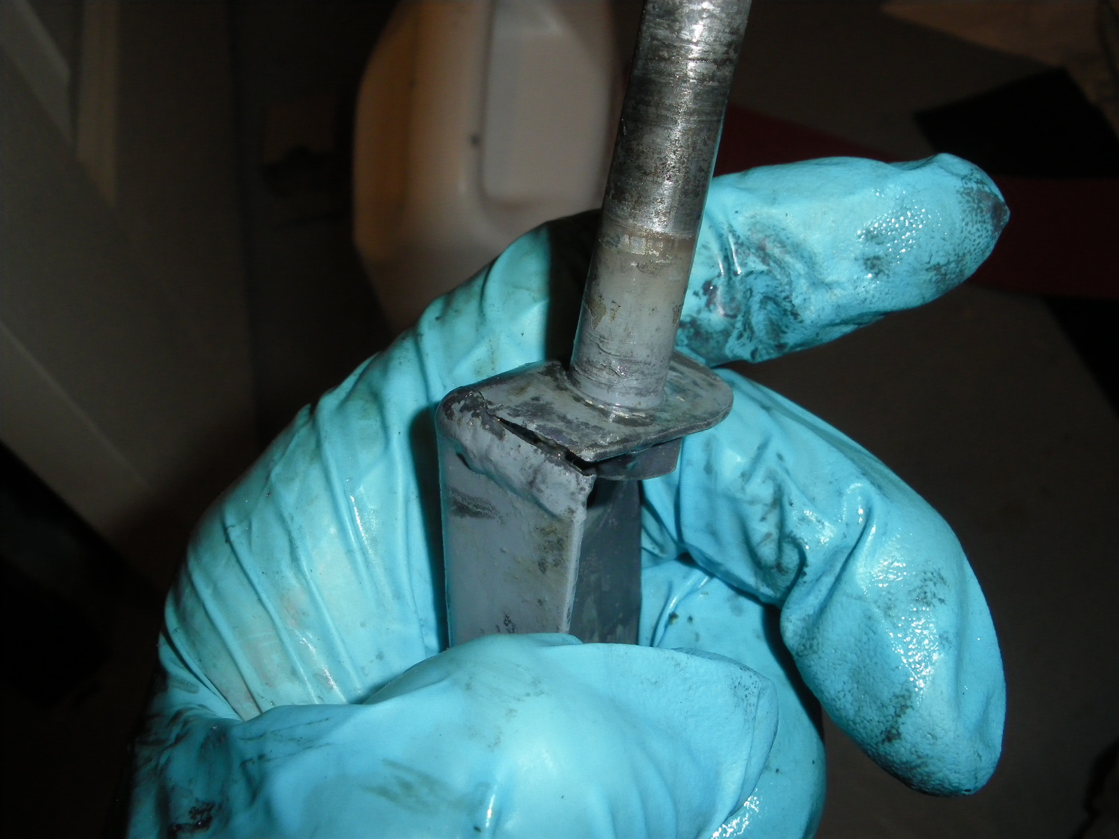

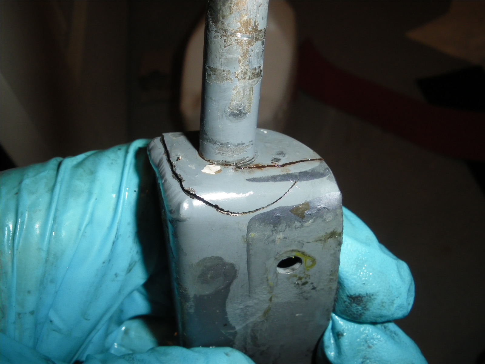

PostPosted: Mon Aug 15, 2011 5:00 pm    Post subject: Update! - 601 owners... something to watch for - engine moun Reply with quote
Hello Group!
Attached are pictures of my two upper fittings. There is a crack next to the weld on the right fitting. There is one long crack that follow the weld and then curves around the bottom on the other fitting. There is also another horizontal crack starting from the bolt to the left side.
I got a response from Zenith Aircraft.  They state that I am the only one that they are aware this happened.  I learned today that one of my friend had a similar issue years ago.  I also found an email about this in the 2004 archive of this list.  The fittings are design to support engines of up to 300 lbs according to the response I got. I intend to make them using thicker 4130. I will also verify with my welder why there are cracks next to the welds.
