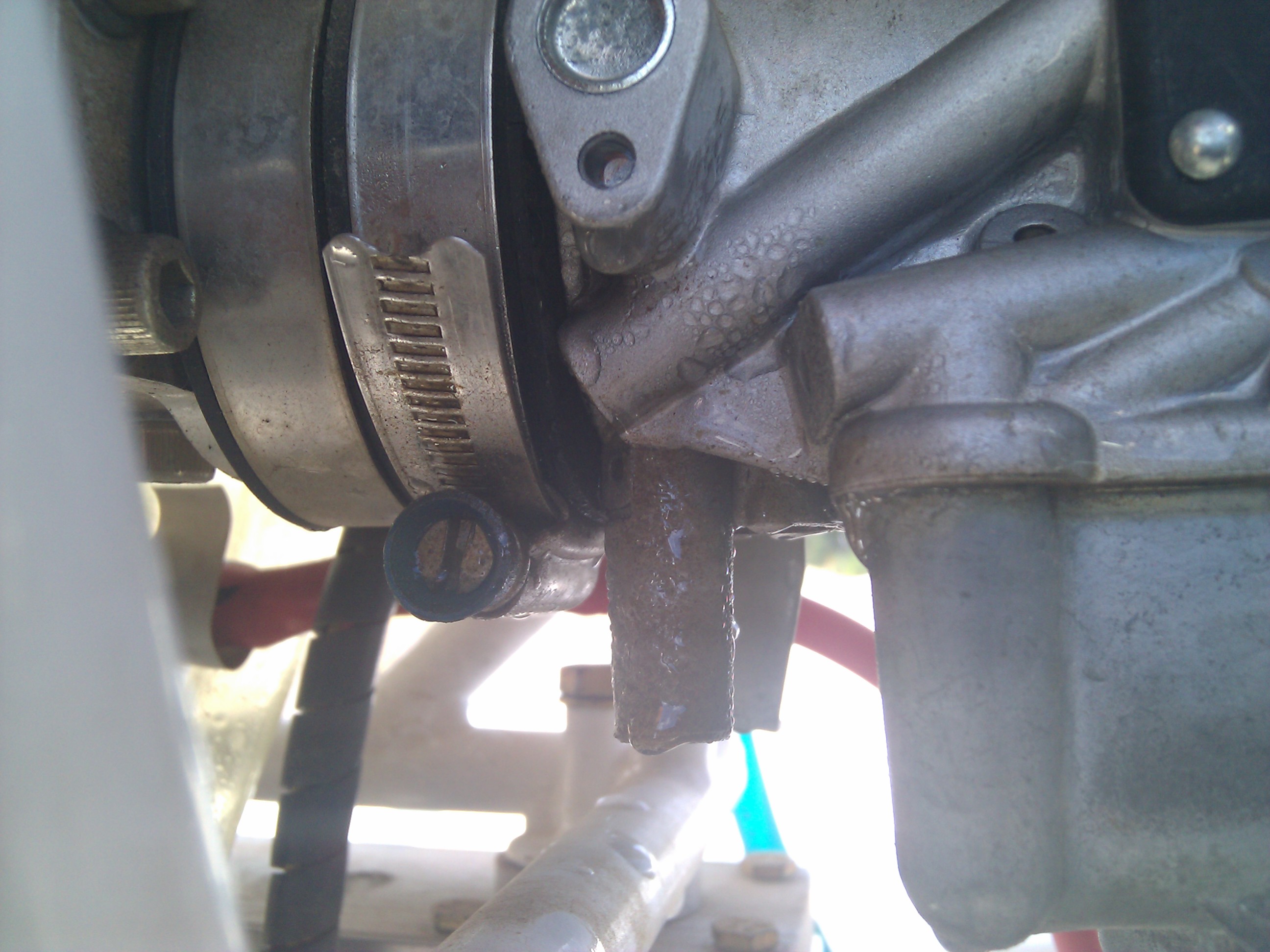

I have almost 5 hours on my new to me Kolbra and enjoying every minute of it, however I am starting to come into some questions I am hoping someone here will be able to help me out with.
First, I will try to attach a picture but not sure if it will come thru or not, but after flying over the weekend I noticed condensation on the carb. At first I thought it was a gas leak but it did not taste or smell like gas. It was almost 100 degrees outside with a relative humidity around 60%. Is this normal? Have you ever noticed this before on yours with these conditions? If so, makes me wary of flying in the winter due to carb ice.

Travis,
The condensation on the carb is probably due the cold carb body (fuel evaporation inside throat) and the relatively high moisture content in the hotter outside air condensing on the colder surface. Just like on the outside of your iced tea glass on a hot day. Does not mean you are having carb ice.
