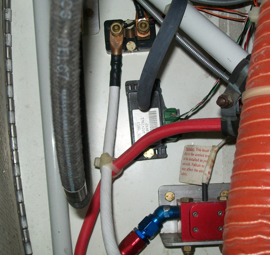

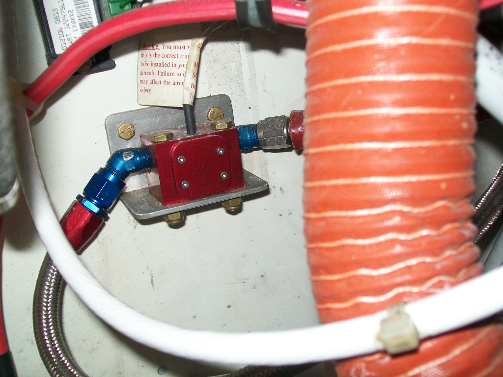

There was a discussion about alternate mounting if the red fuel transducer.  I put mine on the lower right side of the firewall.  Used 45 Degree fittings at the transducer.  No fuel pump fluctuations and not engine mounted.  Both fuel lines are adele clamped to the engine mount to reduce vibration loads on the cube.
