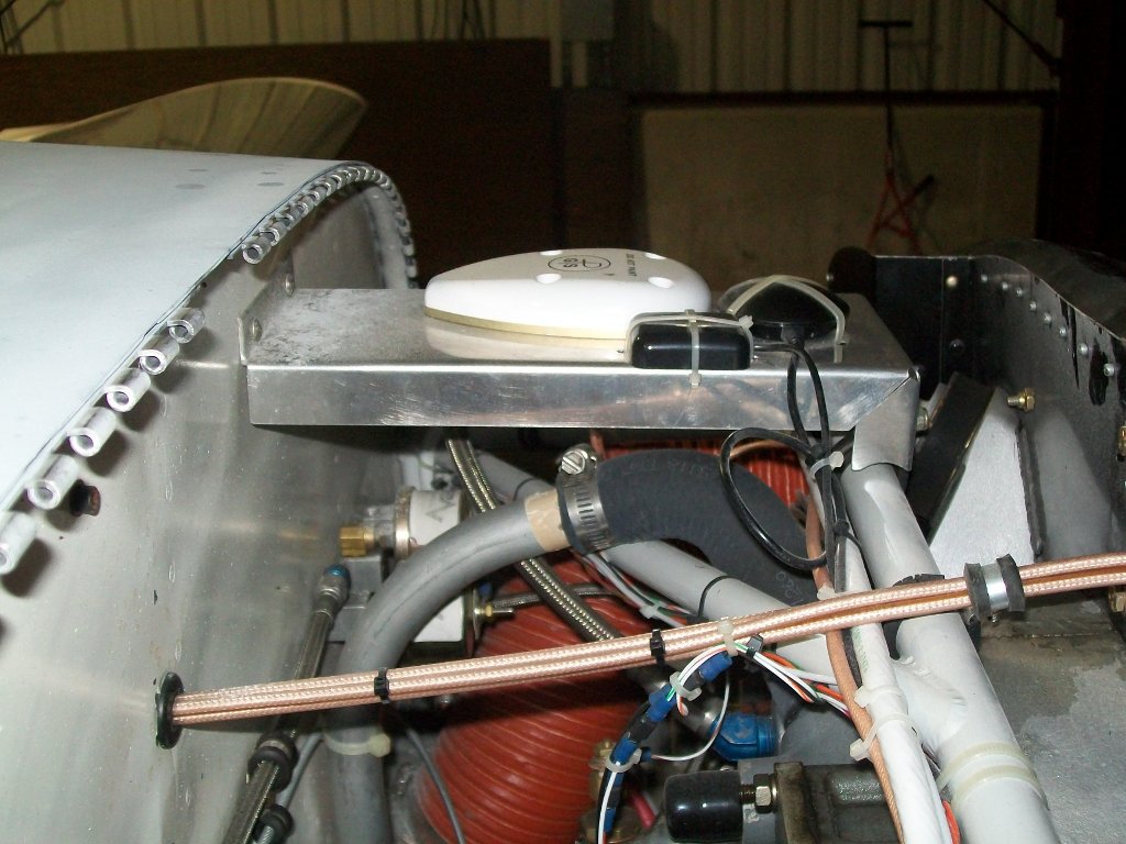

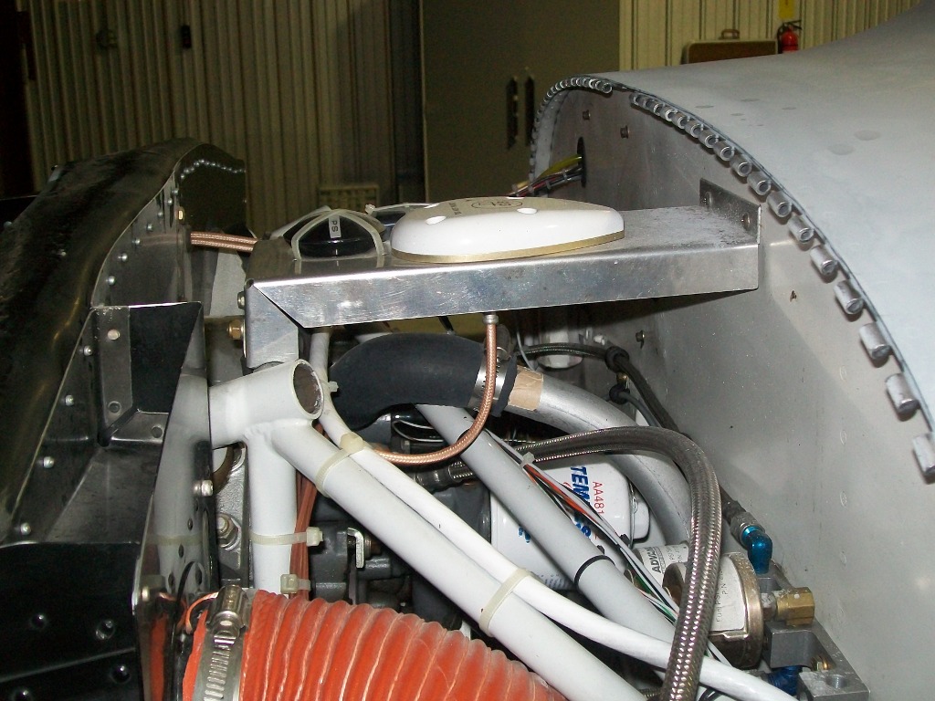

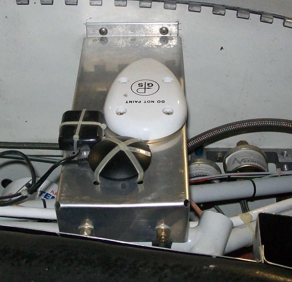

There was some discussion a while back about mounting GPS and Weather antenna's.  Here is my solution.
I have a Garmin 430W GPS antenna, a stand alone GPS serial receiver and the XM weather antenna's all mounted under the cowling.  No issues in 270+ hours.
The stand alone GPS unit drives the AFS Autopilot and the copilot AFS-3500 EFIS.  The Garmin GPS is driving the pilot side AFS-4500 EFIS.
They are forward enough to have a good view of the sky.
The $30 GPS receiver is this one:
http://www.amazon.com/Serial-GPS-Reciever-Cable-Kit/dp/B000VUFGF8
