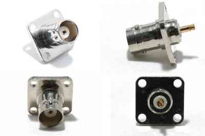

The DIY splitter suggested by Jim Wier was posted by
Tom. This can be even simpler to make than what Jim
suggested. I've uses a BNC "T" adapter
[img]cid:.1[/img]
which feeds the VOR signal through the top
of the 'tee'. Then there's an RF game to be
played off the branch with the 10pF capacitor
and a couple of BNC chassis connectors
[img]cid:.2[/img]
and some long 4-40 screws. You end up with
a more compact and robust version of Jim's
coupler with a minimum of disruption of the
VOR feedline characteristics.
