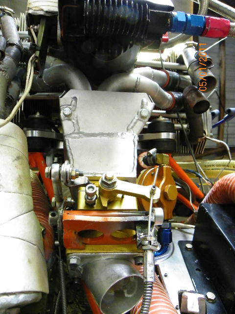

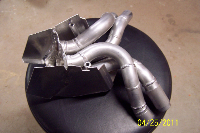

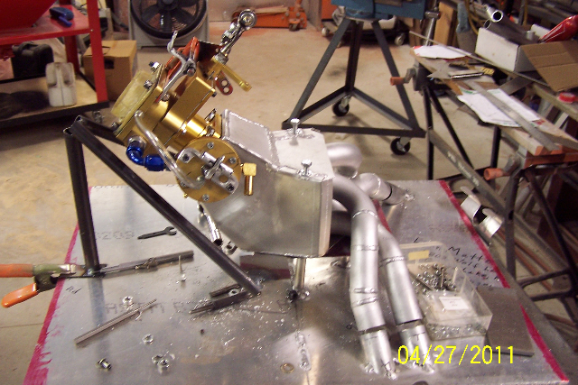

Sorry, one more question. Do you have a picture of the 'ramcharger' intake manifold?

To answer the photos question, here are a few to view in case you
can't get into the Yahoo album area:

Speaking of "finer control".....I almost forgot to suggest that you
make some sort of mechanical device...I made a bellcrank....to
increase the effective length that the throttle control has to move
to make the throttle slide of the TBI move the 40 mm or so that it
moves from idle to wide open. With the suction acting on the back
side of the throttle slide, there is a good amount of pressure
required to make the throttle initially move. Plus there is the fact
that 40 mm of 1:1 mechanical action is a rather coarse way to try to
get fine rpm increments. My bellcrank turns this 40 mm of movement
(of the throttle slide) into about 3" of throttle control movement.
That makes the incremental rpm gains easier to "finesse". Of course,
I also use a vernier throttle for the fine touch, but the mechanical
advantage is better with a longer throw gained from either using a
bellcrank at the TBI, or a quadrant control in the cockpit.
