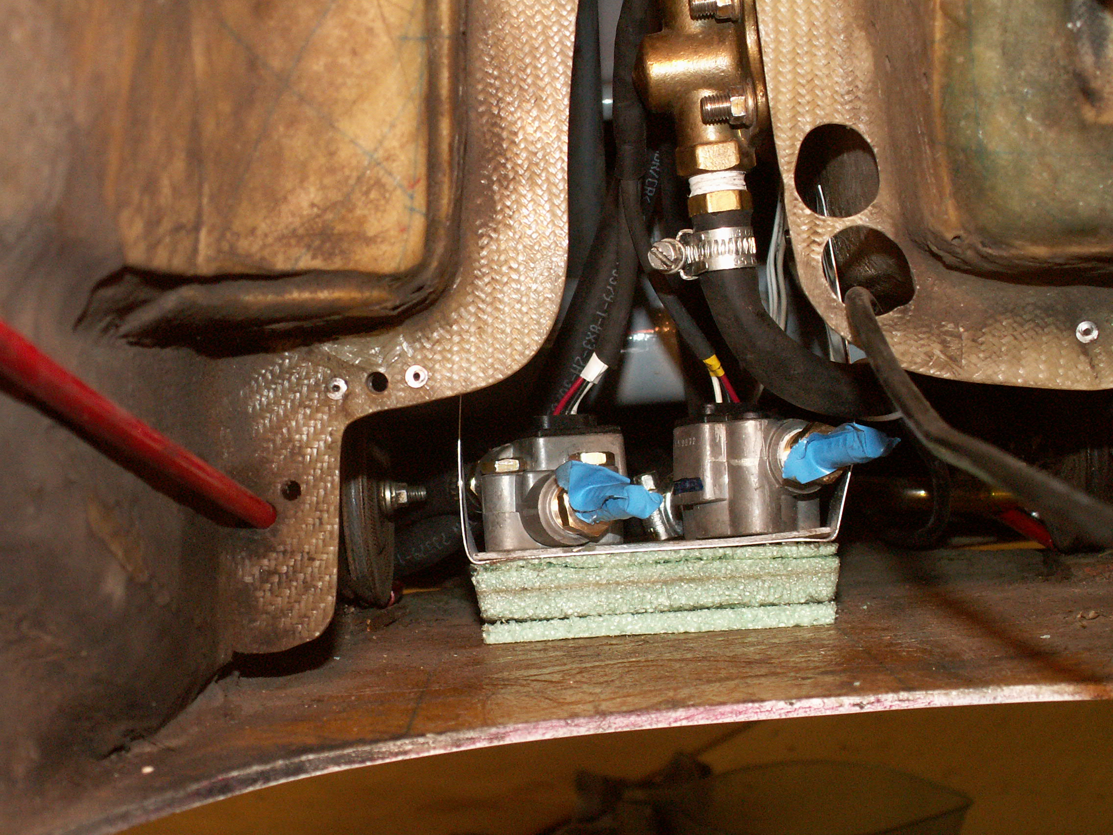

Andrew, The removable bulkhead sits just behind the wheel cut out area in
the fuselage floor, whilst the fuel valve sits several inches further back.
You can see the relative positions of the flange on which the bulkhead sits
and the valve (rather foreshortened) in the attached picture, where I am
shaping up to fitting 2 Floscan transducers for fuel flow measuring.
Regards, David Joyce, G-XSDJ

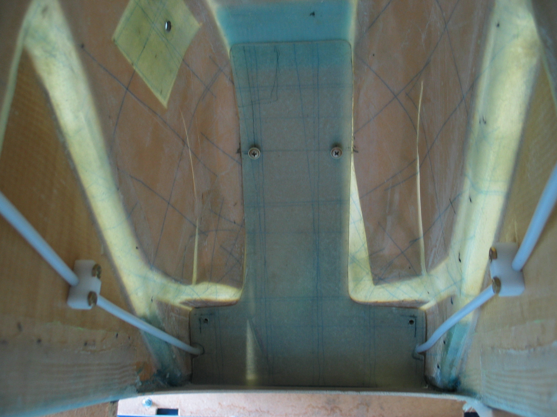

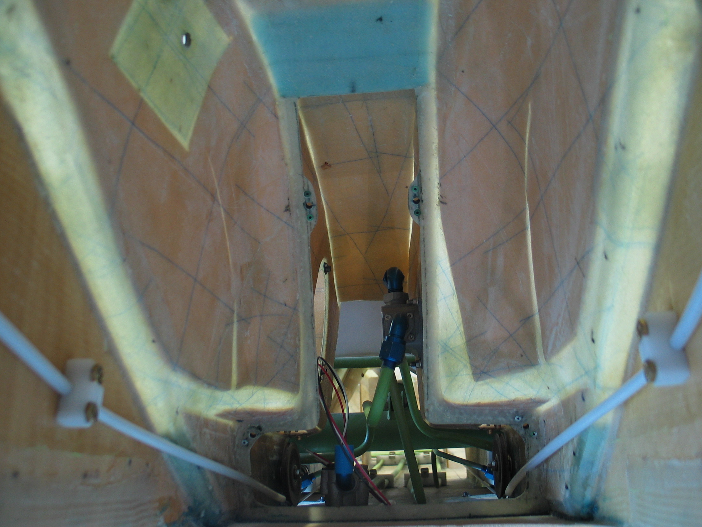

PostPosted: Tue Aug 02, 2011 2:25 am    Post subject: Monowheel bulkhead Reply with quote
Andrew
I did exactly what you are planning. By my calculations the original
bulkhead infringed the access hole. The curved bulkhead works well. Pics
attached I hope.
Lance SAndford in Oz
