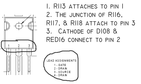

  Bob, could you help me make sure I get the connections to the IFRP3703 right?
It has three "pins", and I'm using the datasheet to identify them.  Although the
datasheet is clear, and easy to understand.....they used a different symbol for
the MOSFET than you did, and I'd like to be 100% certain I'm connecting it right.
  According to the datasheet, looking at the rectifier, writing facing us, and pins down,
pin 1 is the left (gate), pin 2 (drain), pin 3 (source).  (and back thermal pad is drain, also).
On your IvoProp circuit, there are three attach points for the rectifier, could you identify
them for me?
1. R113 attaches to the pin_______
2. The junction of R116, R117, & R118 attach to pin_______
3.  Cathode of D108 & RED16 connect to pin________
the MOSFET than you did, and I'd like to be 100% certain I'm connecting it right..
pin 1 is the left (gate), pin 2 (drain), pin 3 (source). (and back thermal pad is drain, also)..
them for me?
[img]cid:.0[/img]

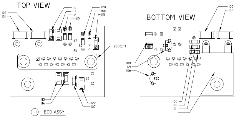

That's okay I have the fets here. BTW, they don't
need to be on a heatsink. The system shuts down
so fast that the un-sinked device doesn't have
time to get hot.
I've got a manufactured assembly about ready to
test. The FET on this assembly is right on the
board with no heatsink.
[img]cid:7.1.0.9.0.20110731005022.03527560(at)aeroelectric.com.1[/img]
The next generation device will have a surface mounted
fet which is smaller yet.
For the record; I had it hooked up correctly. While I was waiting on a return email
about my question, I found a datasheet of MOSFET symbols I originally used to hook it up
like you said to do. The data sheet had several configurations of MOSFETs, including one
virtually the same as the design you had in the circuit.
Very good!
Let me know how it works out.
