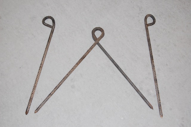

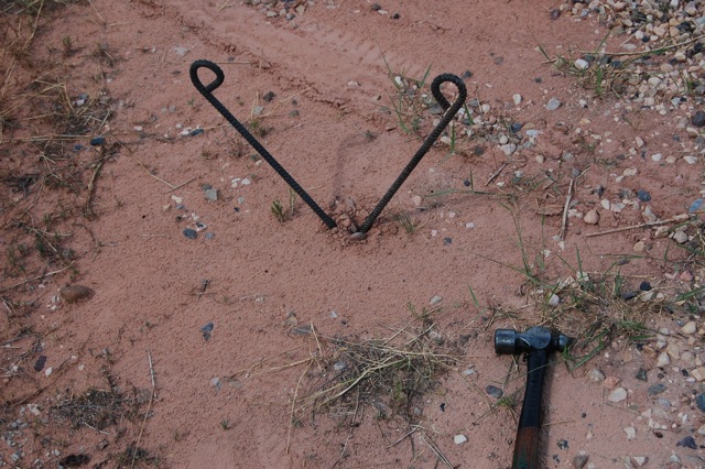

I bet my tie downs would surpass any and didn't cost three bills. I cut 1/2 inch rebar in 25 inch lengths. Grind a point on one end and heat the other end with a torch to form a loop. I drive them into the ground near each other at a 45 degree angle so that when fully in the gowned the loops are together. Easy to tie the rope through. They are next to impossible to pull out either straight up or at an angle. And as recommended by the FAA, they go into the ground about 18 inches. and I drive them into the ground outward and foreword of the wing ties and behind the tail. Ah, weight you say. Yes, nine pounds for all six rebar and a ball peen to drive them in. 2.8 less than Abe's. I have used these for years at Osh and elsewhere without any problems. I hope the photos I have attached come through. If anybody is interested in more info, please contact me offline. My worries at Osh is not that my rebar tie downs will hold, but what the guy next to is using. I made these many years ago after surmising that all the products I saw commercially sold were inadequate.
Paul
RV-4 67KB
