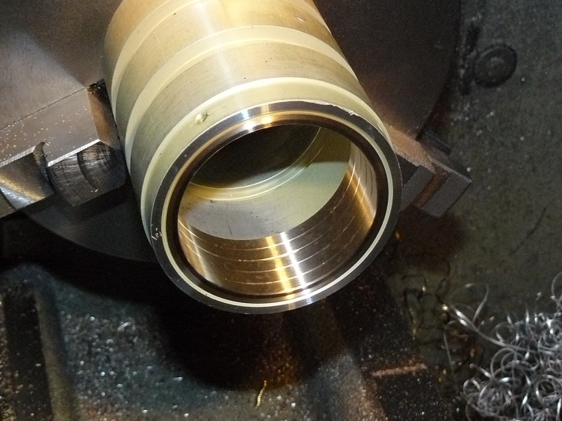

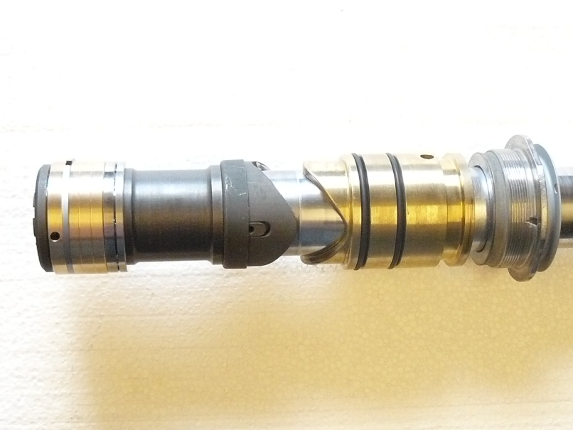

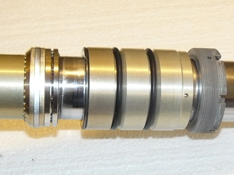

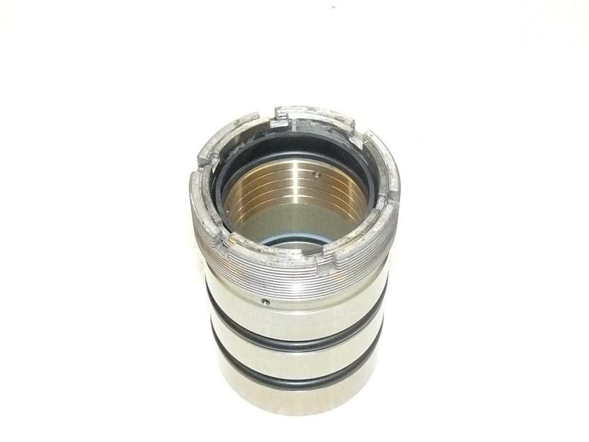

Basically silicone grease is a great lubricant for rubber or plastics and I use it in some places in the actuating cylinders . Or otherwise a heavy lithium grease for the bronce bushes in the landing gear and the ball locks in the actuators. We did a complete landing gear overhaul last winter and found that excessive wear in the bronce bushes showed in the scuffed anodised aluminium bushes. The original felt "seals" cannot keep the dirt out and the grease in the strut so I replaced them by seals used in hydraulic systems. A wiper seal keeps dirt out and an o-ring keeps the grease inside. I´d strongly suggest to do this mod but this may be too late in your case. The action of the landing gear on the ground is a bit stiff still, could be the grease and new bushes. But the unpressurized strut moved smoothly so I suspect with 20 bar in the system the o-rings produce a lot of friction.
The original damper valve has no springs so this creates a lot of backlash and knocking noise on rough airfields, so I did another mod to cure this. But this year still no real test on rough ground done to report.

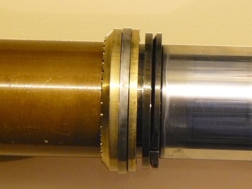

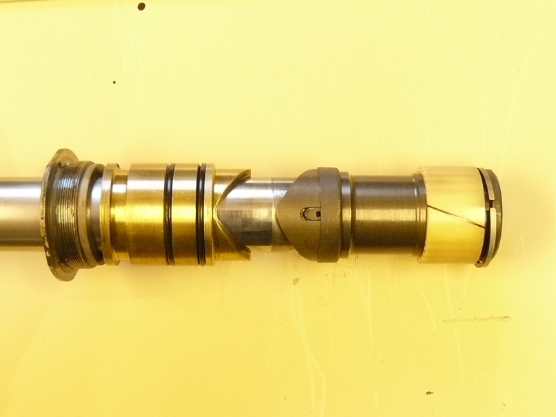

for dismantling the struts you may need two special spanners, as you see in the photo above. Didier, you can have them for a while - winter, I think, would be ideal for the job. Maybe we meet in Eggenfelden some day for you to pick them up. Also I made up some sort of shoe horn to help the piston ring over the shoulder in the strut. This is a pipe with 65mm o.d. and 62mm i.d. and ~200mm long cut in two halves. The nose wheel is different by few mms, I can check sizes later. The seals can be found in hydraulics industry supplies for piston rods with 52mm and 50mm dia. as dust wipers. And next to these I put o-rings in to keep the grease inside the strut. You need adapter rings for the seals to position them in the milled nut where the felt was before.
The photo below shows the spring loaded damper valve with no backlash to get rid of the knocking on rough airstrips. Still not yet tested on real rough stuff but I am confident ...
