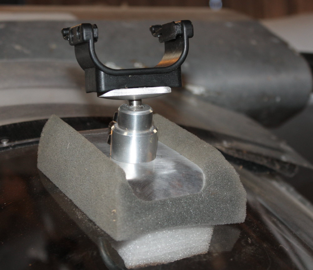

The real key to camera stability is the foam. I first tried the foam that "Cool cups" were made of. The kind that you put pop or beer in to keep cooler. Worked great, one time. Then took on the shape and was no good. Then I used the foam that electronic equipment was packed in. It is really dense, and is made up of about 5 layers glued together. I has a much less tendency to compress, and if you remember and back off the pressure until you get ready to fly, will not take a shape.

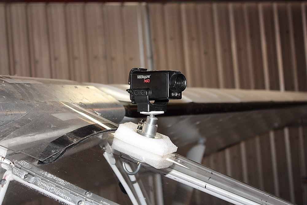

I decided to use the top of the wind screen as a mount. On my last flight I felt every thing from the wing to the struts in an attempt to find the least amount of vibration. The wind screen was it. It also would have the advantage of being within reach. The camera that I am now thinking of is the drift HD. It has a remote that you can use, but with this location, I can reach out and do it by feel as well.
[img]cid:03C0F44DF75D4328B16EDB330A540E1B(at)larryPC[/img]

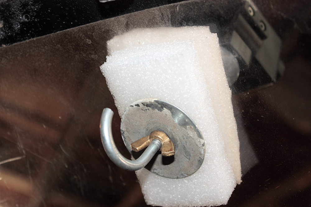

The mount consists of two pieces of the foam, two large washers, a 1/4 x 20 threaded bolt bent in a curve, a wing nut, and a regular pivoting camera mount.
[img]cid:42ACD08909C5490C88D3616C9F591891(at)larryPC[/img]

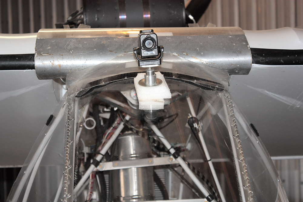

The curve is important as it will tell you which way the camera is facing, and allow you to take video's from the side as well to keep the thing aligned.
[img]cid:C90D91D470EB4E81AC12C093F1C41607(at)larryPC[/img]
I can see that I need to adjust the level before I fly. The foam is the key, and the test show that the nose of the plane is just visible, which is not bad, and the harmonics are gone. The good part of the whole thing is that it only requires one small 3/16 or so size hole in the screen.

OK, final test today. Yesterday I flew with the stiff foam under the camera. If I screwed it down tight enough to not move around, then I had shake from the motor. So today I used a soft piece of foam about 1 inch to 1 1/2 thick under the top mount with a alum backing plate, and the stiff stuff against my windscreen on the underneath side. I also compressed it enough to firm it up, and half way through the flight, I screwed it down even tighter.
[img]cid:8FE90B414B6147A0BE49F884D3C800E8(at)larryPC[/img]
Much better all the way around. See for yourself.
http://vimeo.com/26234130
There has always been mention of how stiff the ailerons are on Kolbs, and they are. However we must not forget that the Kolb is a rudder airplane. The turns were possible only when I was using the rudder, and by leading the turn with the rudder, the ailerons were not noticeably stiff. At least I wasn't aware of them being a problem. Ground speed was mid 60's

PostPosted: Sun Jul 10, 2011 2:22 pm    Post subject: mounting Video Camera's Reply with quote
LarryYou've obviously licked the mount problems. But you have a strong magenta cast in earth/road/some brush. I don't know these cameras. Is there any adjustment on the camera?
Wonder how the new one will do?

PostPosted: Sun Jul 10, 2011 3:14 pm    Post subject: mounting Video Camera's Reply with quote
No, there is no adjustment, it is possibly because it was early in the morning. I wouldn't fly that way at any other time, except perhaps late evening, and the wind generally blows pretty enthusiastically here. As for the new one, I will have to let you know. I suppose to a large extent, it will depend on how much you pay for the camera. These are not very expensive and as Rick said, best described as "throwaways"
