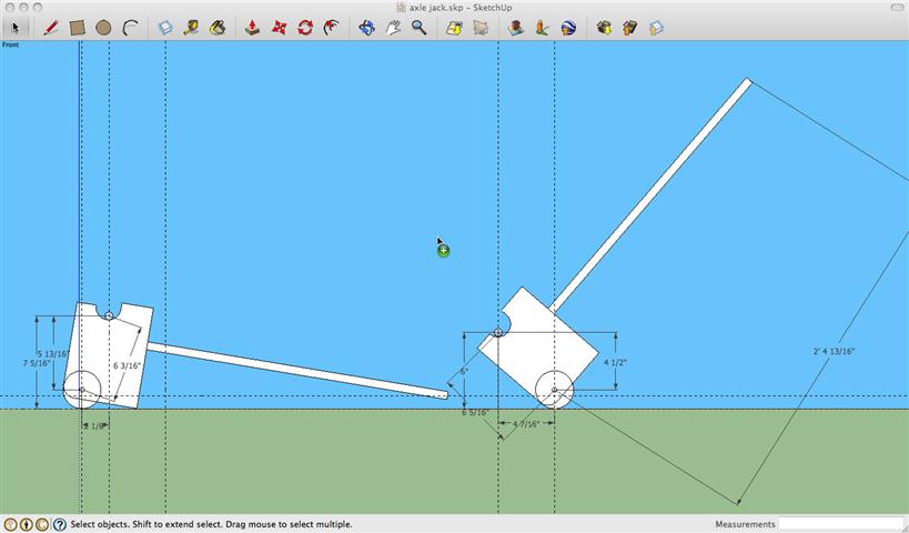

Fellow Kolbers,
A few months ago, the check valve in my cheap hydraulic jack failed so I put my thinking cap on and designed a cheap, light-weight (even portable for field repairs) quick to use axle jack for Kolbs or other aircraft with axles that extend away from the wheel a bit. I've attached an image of the drawing/sketch that show the working dimensions. If anyone is interested in more details, I'll be happy to provide them, including the build dimensions and materials I used. I plan to make a short video of it in operation on my Slingshot and post that too.
Kolb Axle Jack.tif
 Filesize:  351.5 KB
 Viewed:  6096 Time(s)
Kolb Axle Jack.tif

For those who can't open a tif file, attached is a jpg version.
 Filesize:  43.57 KB
 Viewed:  6051 Time(s)

PostPosted: Sun Jul 10, 2011 12:13 pm    Post subject: Re: Kolb Axle Jack Reply with quote
BB,
The need or a "twofer" has not yet arisen in my hangar so I've not rigged one Smile.
Just before flying out to your place this morning, BB, I made a short video of the axle jack at work. Note the little triangular piece I cut off of the 2x8 corner is used as a security chock, if leaving the jacked airplane for awhile with the wheel off. The over center is enough to keep it locked in place, unless someone gives the Kolb a big push. This little triangular piece prevents it from coming back over center and falling, even if someone tried to knock it off the jack.
To jack higher or a Kolb with larger diameter tires, just place a 2x6 under the jack and it will raise the axle another 1.5" higher. I used the handle from my dysfunctional hydraulic jack but one could use a hardwood dowel.
I know this is simple and nobody asked for this but I've found it to be quite useful. Worth what you paid for it, as at least one Kolber often sez.
