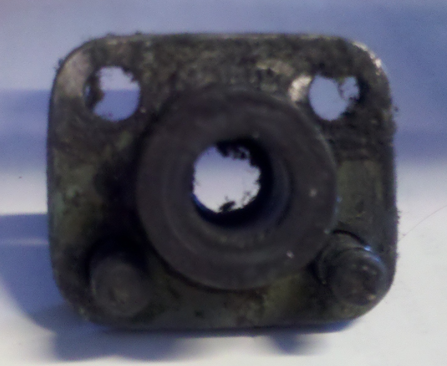

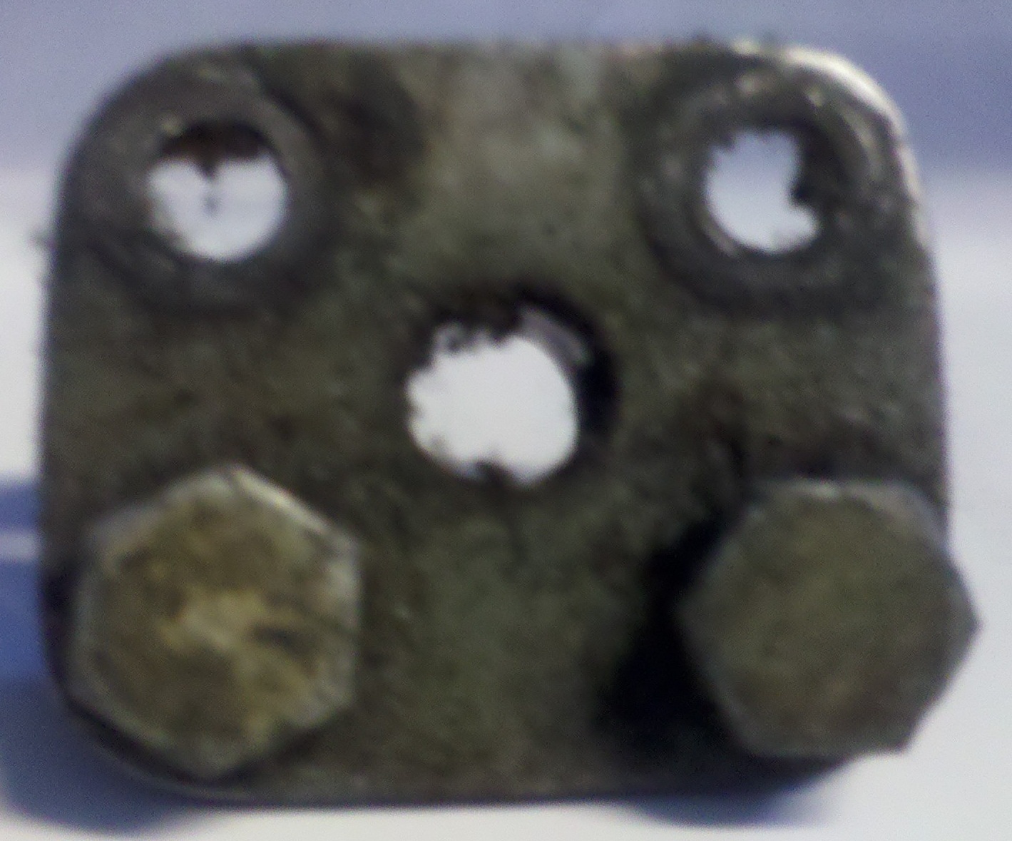

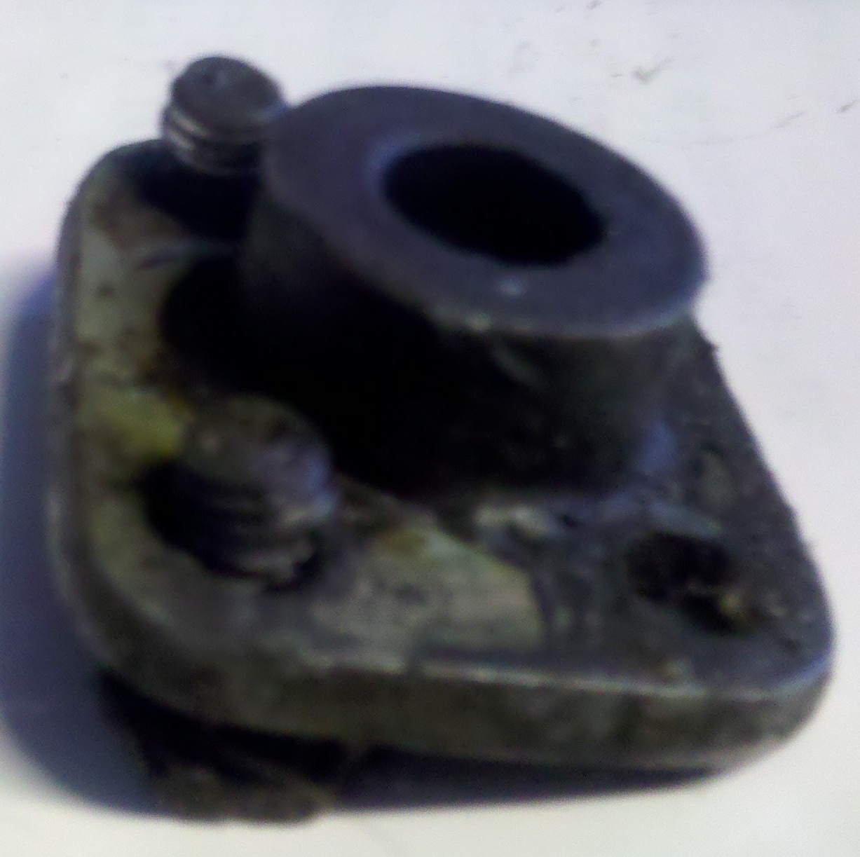

Yesterday after my flight, I found a small 1" x 1.25" (approx) metal plate with two screws and a hole in the center. It was at my gib's right foot. I'm trying to identify it and figure out where it belongs.
Any ideas?
Pictures are attached

I could be an instrument panel mount . I'll check my plane later today .

It appears to be an avionics shock mount from the instruments behind the pilots seat..

I believe it is the end cap / pivot bearing for rudder pedal position
adjusting screw. Probably from the rear cockpit..
With a mirror and flashlight inspect the forward end of the adjustment screw
housing in both cockpits. You will see a notable difference if that is the
case.
Walt

---- Thomas, Looks like one of the old radio mounts.

Further to my last - confirmed today that identification is correct.

Yep, that was it. Got some new screws & going to put it back on tomorrow. Without it, no rudder control for the gib! Thanks for the help.
