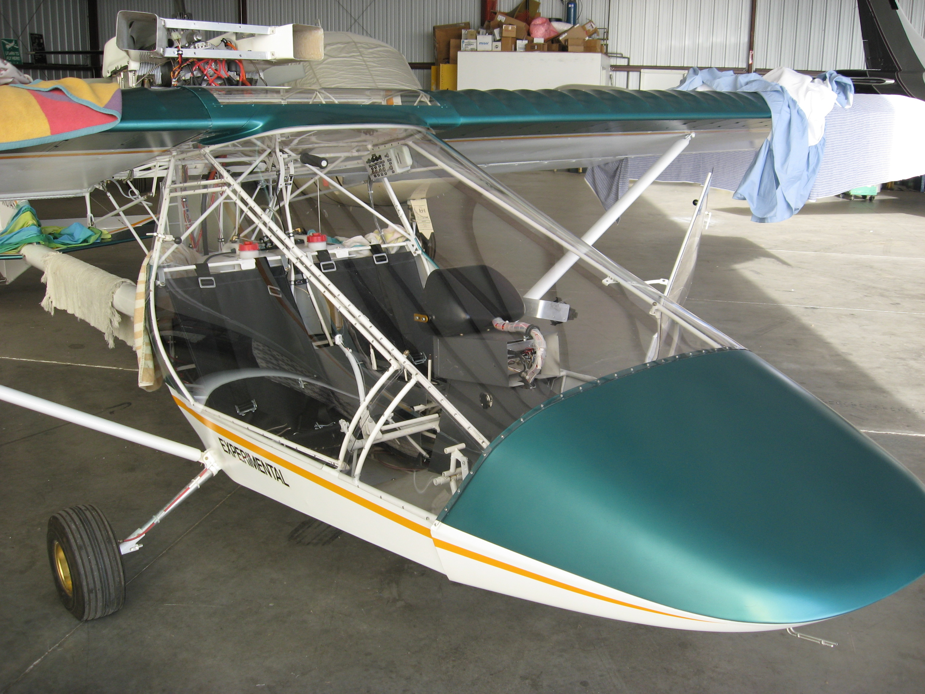

Had my first flight in my M3X today. For those who remember that day here is my experience.
Wind was calm and we were waiting for some low clouds (Fog) to burn off at Hollister, Ca. Decided to do some high speed taxi tests to help run-in the brakes and had three runs up to 35-40mph with good control. On the forth run added “Just a little more power� to see if I could get into ground effect but was fully ready to fly.. Sure enough, off she went up to about 20feet. Started to lower the nose to put it back on the runway but found I got a rather sudden few oscillations in pitch as I tried to get used to the elevator. Put in full power to gain altitude and went “up�. Found I had to hold “LOTS� of forward stick to keep it above 60 and continued to climb. Jabiru 2200 Engine ran fine.
Went to 1500 feet directly over the runway and varied the engine RPM. VERY heavy forward stick needed to maintain straight and level even with cruise RPM’s of 2500. CHT showed 380 Deg F so decided to land.
Eased back to 2000 RPM and started a decent. Still needed forward stick about 3inches forward from where the elevator was level with the Horz Stab. Stabilized any oscillations. Set up an approach but it seemed high about ½ way down the runway and so I did a circuit and lined up at the start of the runway. Eased off to about 1500 rpm, stick still pushing forward, 60 MPH, nice decent rate, came into ground effect and had a good landing about 1/3 down the runway.
A few things:-
1/ Thank God for 6000 foot runways, my plane is WAY out of trim. And having LOTS of runway allowed me to not over control at a critical time.
2/ Take some time in a flying kolb with a pilot if you can, I flew in a MarkIII the day before and it really helped (Thanks ChrisB).
3/ FLY the plane. In calm no-wind conditions for the first flight.
WHY SO MUCH DOWN ELEVATOR NEEDED?
a/ During my building I got an update to the plans that set the LE of the horizontal Stab just above centerline of the boom tube. The original plans called for the LE to be level with the TOP of the Boom tube.
B/ I always thought my wing incidence compared to the Horizontal Stab. was very high so will recheck the wing root attachment to make sure I did not miscalculate and drill incorrectly.
Does anyone have data about the angles of incidence between the Wing bottom, the Horzontal Stab and the engine thrust line for a MK3?
B/ My Weight and Balance may be off but I triple checked it – Time to do again. I calculated my CG was 16inches from the wing LE – Mid range.
Its good to have flown but better to have survived!
Will post Pics and video later.
FrankD

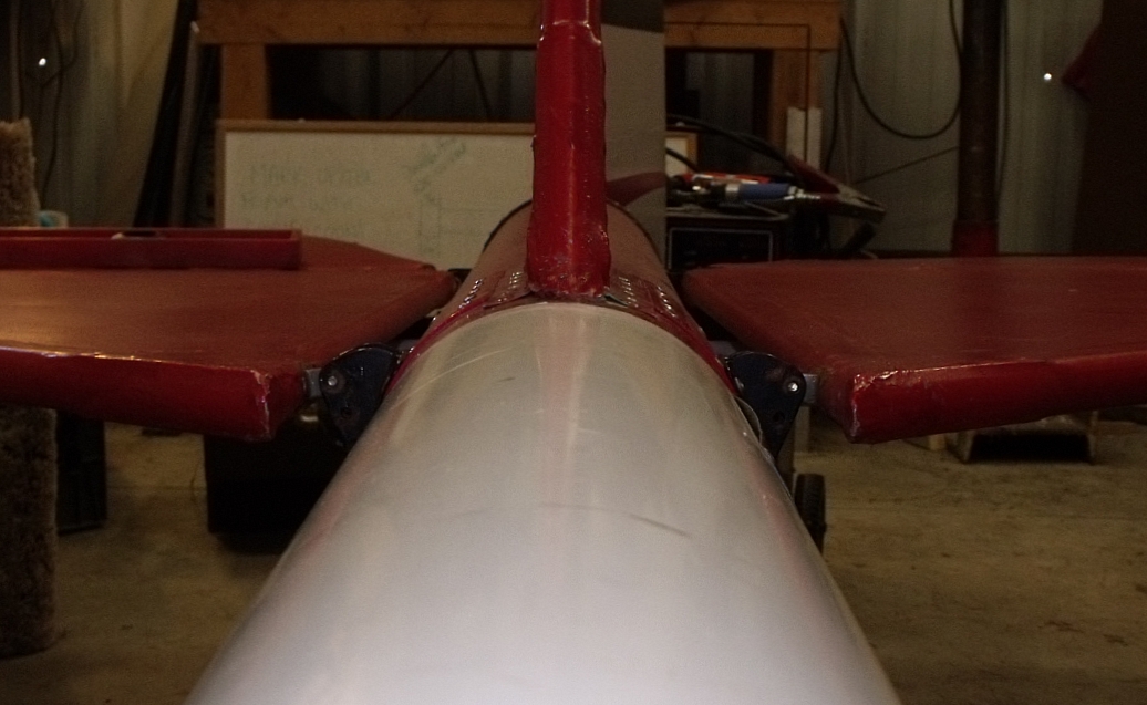

Attached is a picture of the tail incidence on a Mk IIIX I have in the shop right now. I think it's fair to say the incidence of the HS on your airplane is a couple of degrees lower (based on TLAR estimate that about .40" change at the leading edge is one degree). One thing you might look at before dealing with stabilizers is how your flaps and ailerons are rigged. If they have a bit of reflex to them you will get the same effect, i.e. stick forward required for level flight. If you have them rigged so that the bottom of the wing and the bottom of the flaps and ailerons are parallel, you could try a turn or two on the control rods to crank in a bit of camber. A little won't effect drag very much and might solve your problem.
If you find you need to move the brackets on the boom, I have some boom tubing that Travis was generous enough to send along to me at no charge so I could make patch plates for the airplane pictured (a Mark IIIC to X conversion). Least I can do is send along a piece if you want to make cover plates to hide the extra holes.

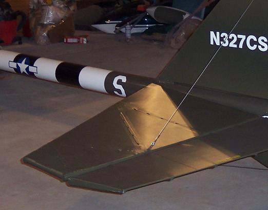

PostPosted: Mon Mar 14, 2011 7:35 pm    Post subject: Re: N1014S MarkIII Xtra first flight - Frank D Reply with quote
Boyd,
Yours sounds like mine....seee picture...
chris ambrose

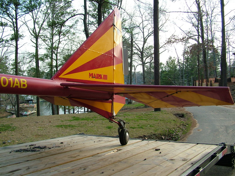

Boyd Y/Gang:
February 1991, I was lucky to fly off most of the 40 hour test time on the
original Kolb MKIII (long before there was such a thing as a MKIIIc or a
MKIIIx). I knew nose down pitch was a problem, primarily because of the
high thrust pusher configuration of the Kolb, nothing more than a long lever
trying to push the nose of the aircraft down when under power.
While Brother Jim and I were fabricating the fuselage on my MKIII at Kolb,
Jim designed and fabricated adjustable horizontal stabilizer leading edge
mounts. We decided on three positions. During initial testing of my mkIII
the middle position seemed to be the "sweet spot", where the aircraft was
most comfortable to fly at cruise power. Some years later, in an attempt to
squeeze another mph or two out of the little airplane, I played around with
different adjustments, but always came back to the center position. The top
and bottom position would cause the aircraft to feel as though I was trying
to balance on a ball. It wanted to roll off fore or aft, but never settle
down to the cruise attitude.
With no power, gliding, pitch trim in the neutral position, my mkIII flies
nearly hands off. But, when power is brought up, it is necessary to add
nose up pitch. When flying an adult passenger, I must use max nose up pitch
trim. It is the nature of the beast.
A screw jack set up like a J3 Cub would be nice, but that would have
required a complex modification to the mkIII.
I've got some photos of our set up. If I can find them, I will post them.
This is the only one I could find. Should give you an idea of where I fly
the leading edge of the horizontal stabilizers.
john h - Getting ready for Sun and Fun.
 Filesize:  234.6 KB
 Viewed:  19478 Time(s)
