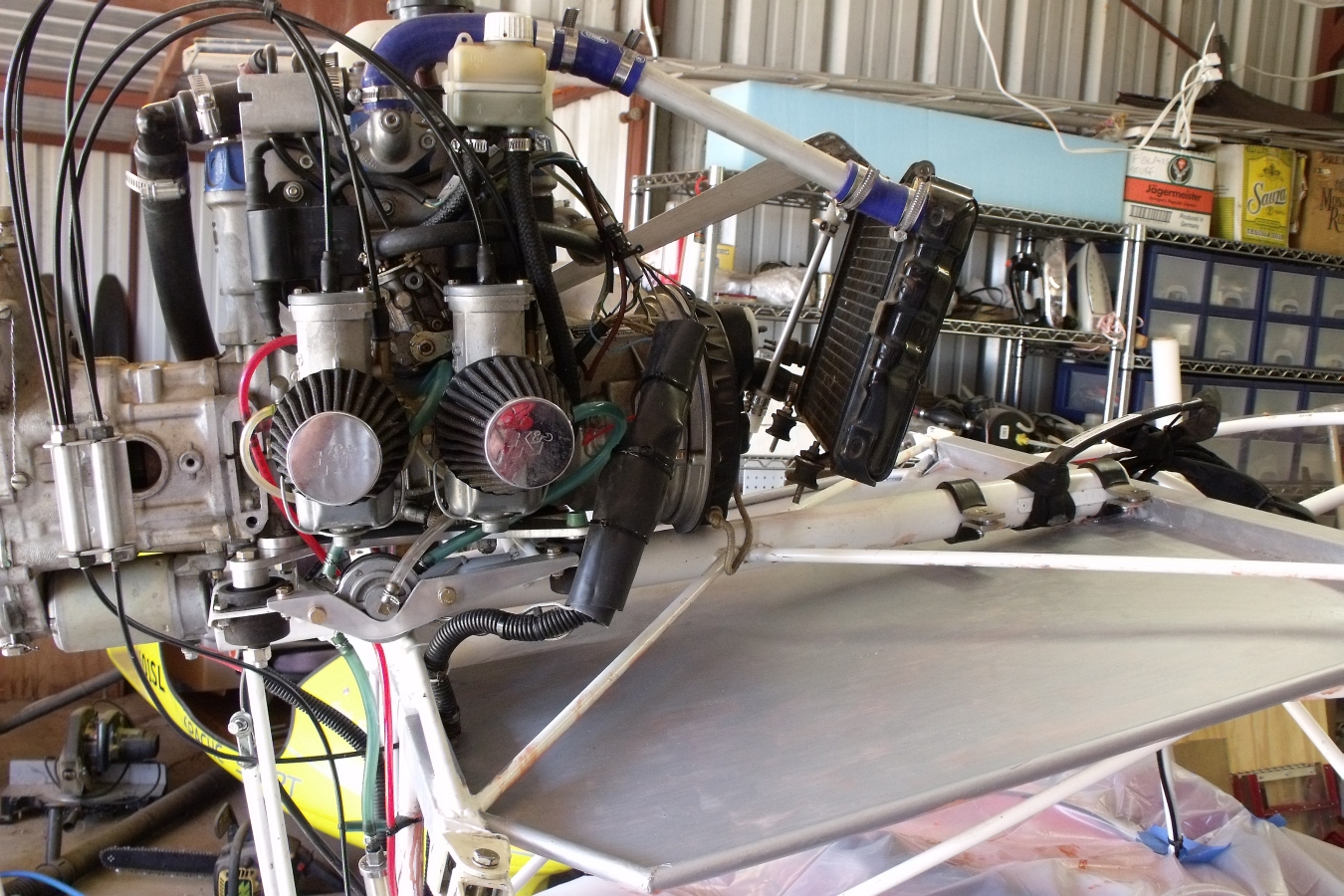

The latest changes have been made to Ken Holle's Mk IIIX and flown with mixed results.The changes were covering the engine mount frame and lowering the engine to the stock height (nearly, anyway, I have 1/2" spacers on the aft mounts).

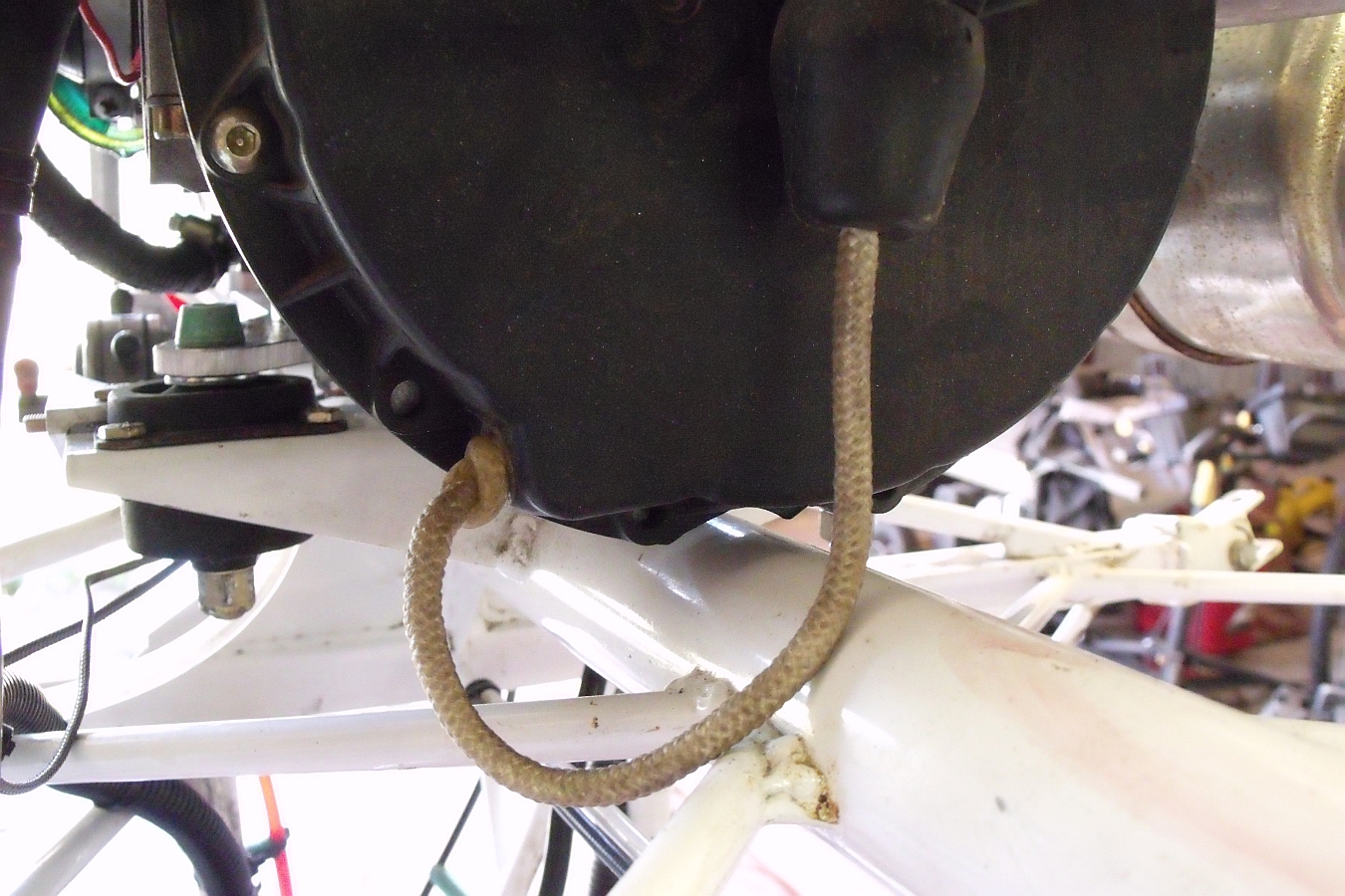

To accommodate the latter change a new engine mount plate had to be made to move the engine back 3/4" so that the "E" gearbox electric starter clears the rear spar carry through. I've attached .pdf and .dwg files of the new plate. I also had to provide some clearance for the engine mount tube on the pull starter flange of the engine. I channeled Paulie on "American Chopper" and sanded a divot in the flange with my right angle dotco.
Covering the engine mount frame produced the most interesting results. The climb rate literally doubled even though I swapped my 66" diameter WD prop for Ken's 70" diameter WD prop. I also had to add almost 3 degrees of pitch to the prop.
