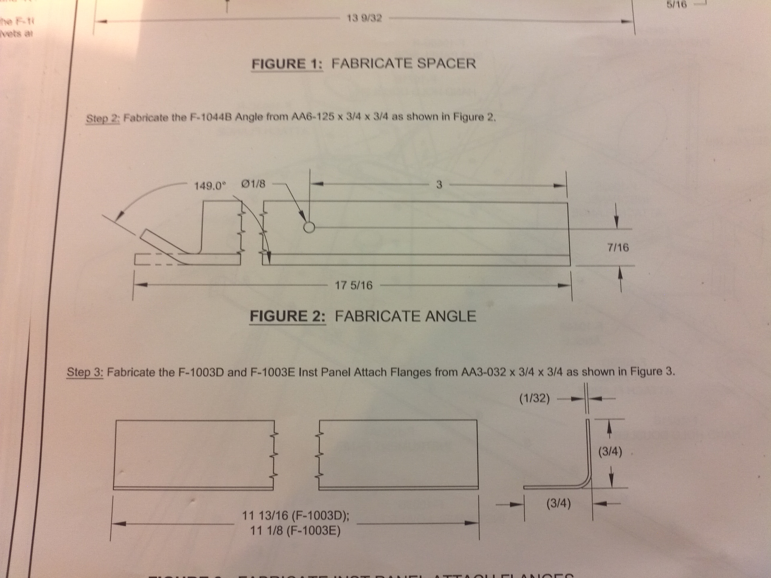

Good morning all!
I am working on page 31-2 and am having some trouble figuring out exactly what F-1044B is supposed to look like when I am done.  Do any of you guys have a picture of this piece?   That 149 deg bend has me scratching my head today!
Shannon

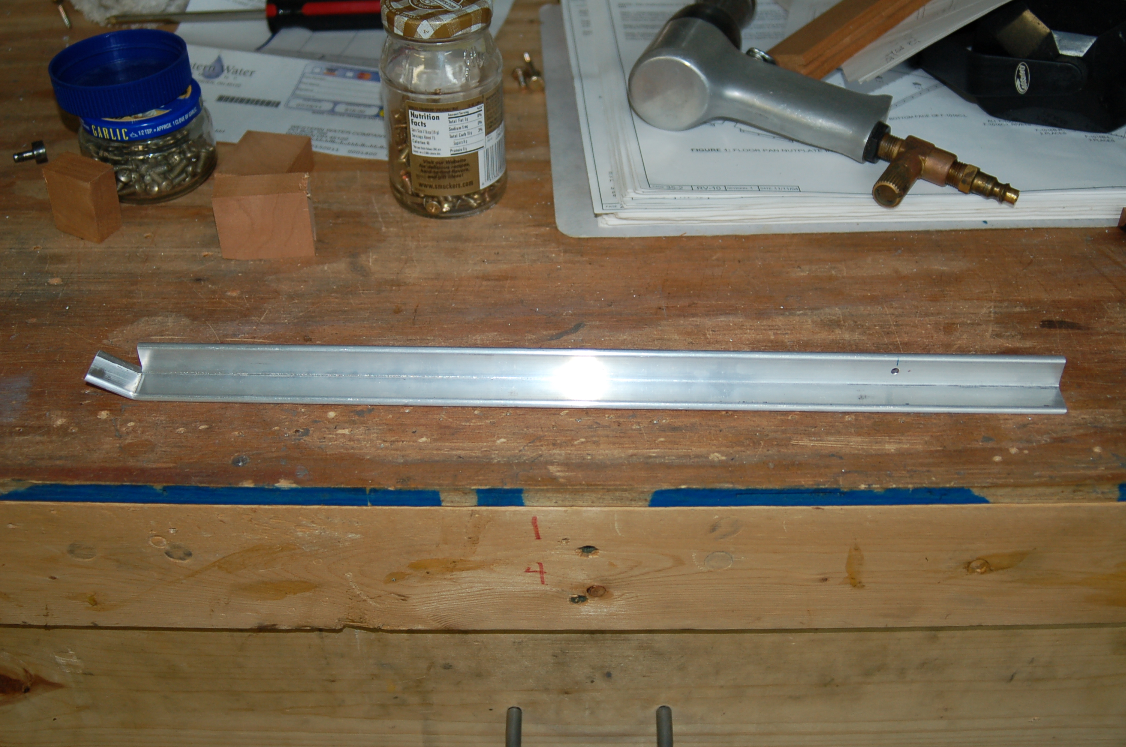

Attached - 2 pictures, first showing the piece as fabricated, the second
shows it 'in place'.
Hope it helps.
--Ron

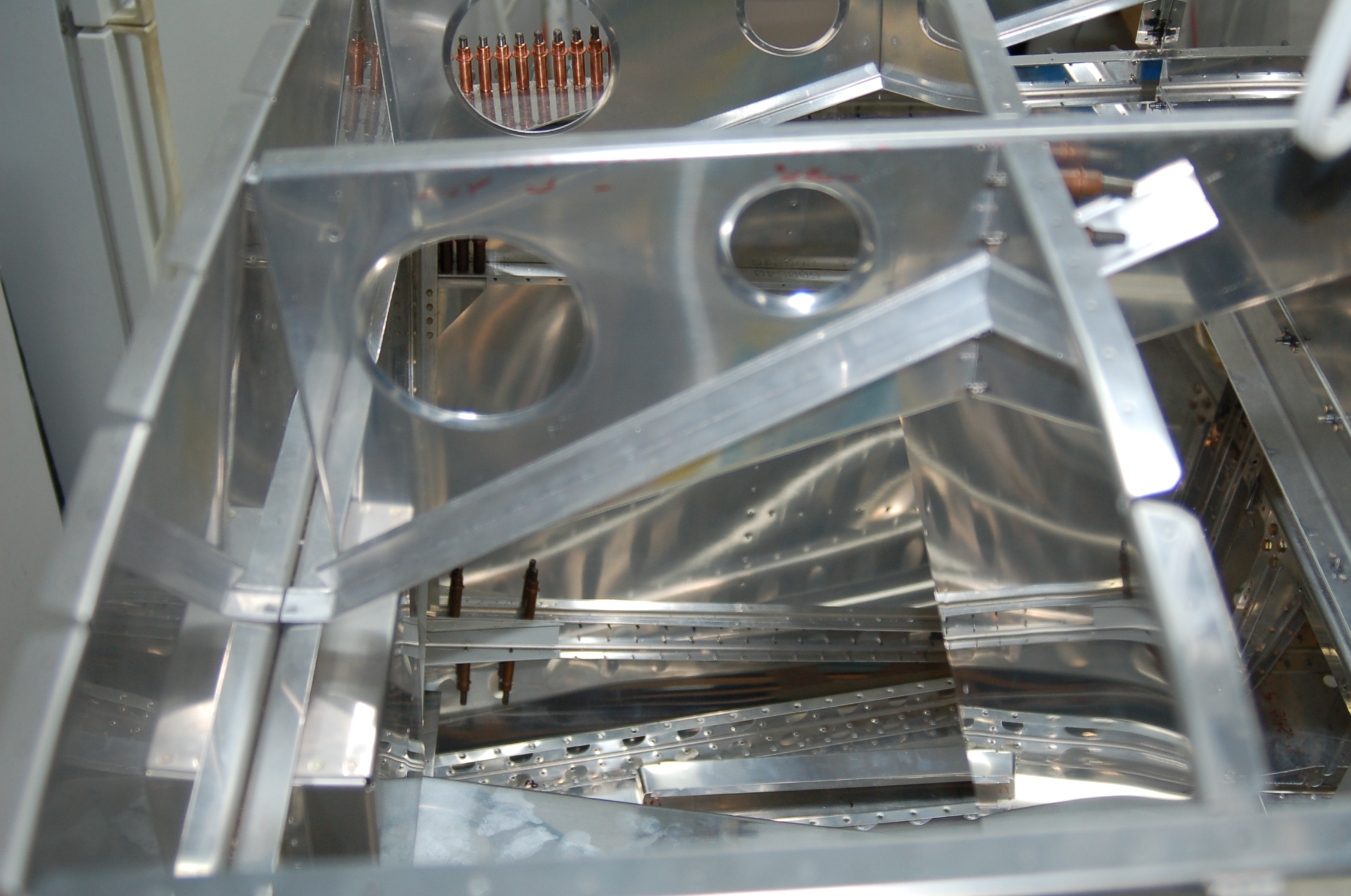

PostPosted: Mon Jul 04, 2011 8:12 am    Post subject: F-1044B fabrition Reply with quote
It is the aluminum angle you see to the right in the picture at the below link:
http://wcurtis.nerv10.com/08Fuselage/fuselage31f.html
The rivet up against the firewall angle is hard to get to and you may want to put a nut and bolt there instead.

PostPosted: Mon Jul 04, 2011 8:33 am    Post subject: F-1044B fabrition Reply with quote
Brain freeze perhaps. I don't have a picture but I know the part.
Try rewording Step 2 to read, "Fabricate part F-1044B from AA6-125 x 3/4
x 3/4 angle as shown in Figure 2".
That unfreeze the blockage.

PostPosted: Mon Jul 04, 2011 9:22 am    Post subject: F-1044B fabrition Reply with quote
Thanks Ron. I was confused about the orientation of the bend. I wasn't sure if I was supposed to cut the flange or not. On Jul 4, 2011 12:07 PM, "Ronald Walker" <n520tx(at)gmail.com (n520tx(at)gmail.com)> wrote:> On Mon, 2011-07-04 at 10:09 -0500, Shannon Hicks wrote:
