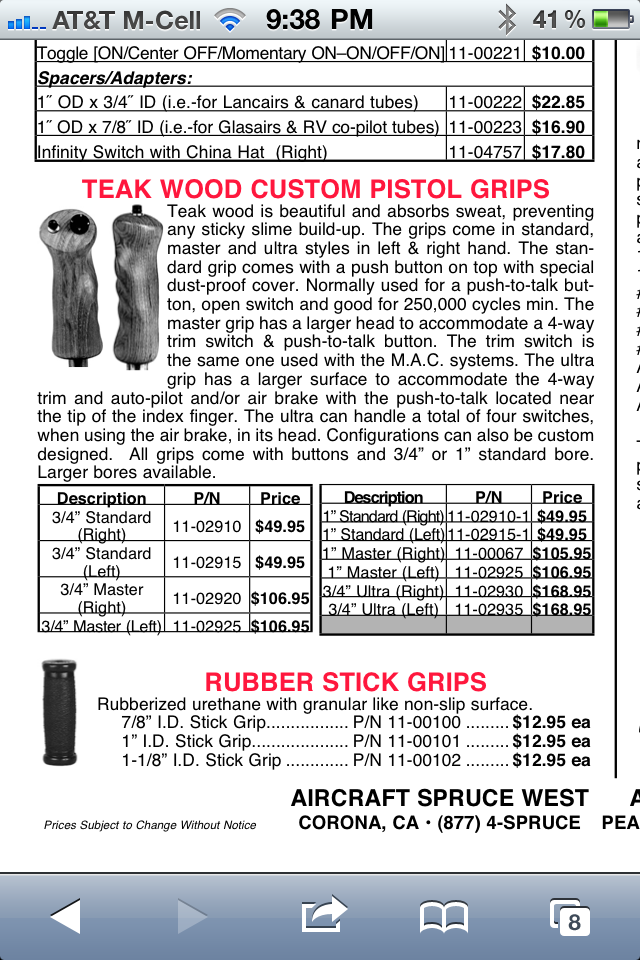

I used the Teak wooden grips on my RV-4 and liked them so much that I am using them on my RV-10. I have the coolie hat for trim, a PTT and an autopilot disconnect. I am very happy with them.
-Mike Kraus
40013, 19.8 hours

Kelly McMullen
Joined: 16 Apr 2008
Posts: 1188
Location: Sun Lakes AZ
PostPosted: Fri Jul 01, 2011 6:13 pm    Post subject: stick grip Reply with quote
Vans or other source?
Disregard. Didn't see the image attached .

PostPosted: Fri Jul 01, 2011 11:03 pm    Post subject: stick grip Reply with quote
Oops, I didn't see the image either--my grips are from Vans.
