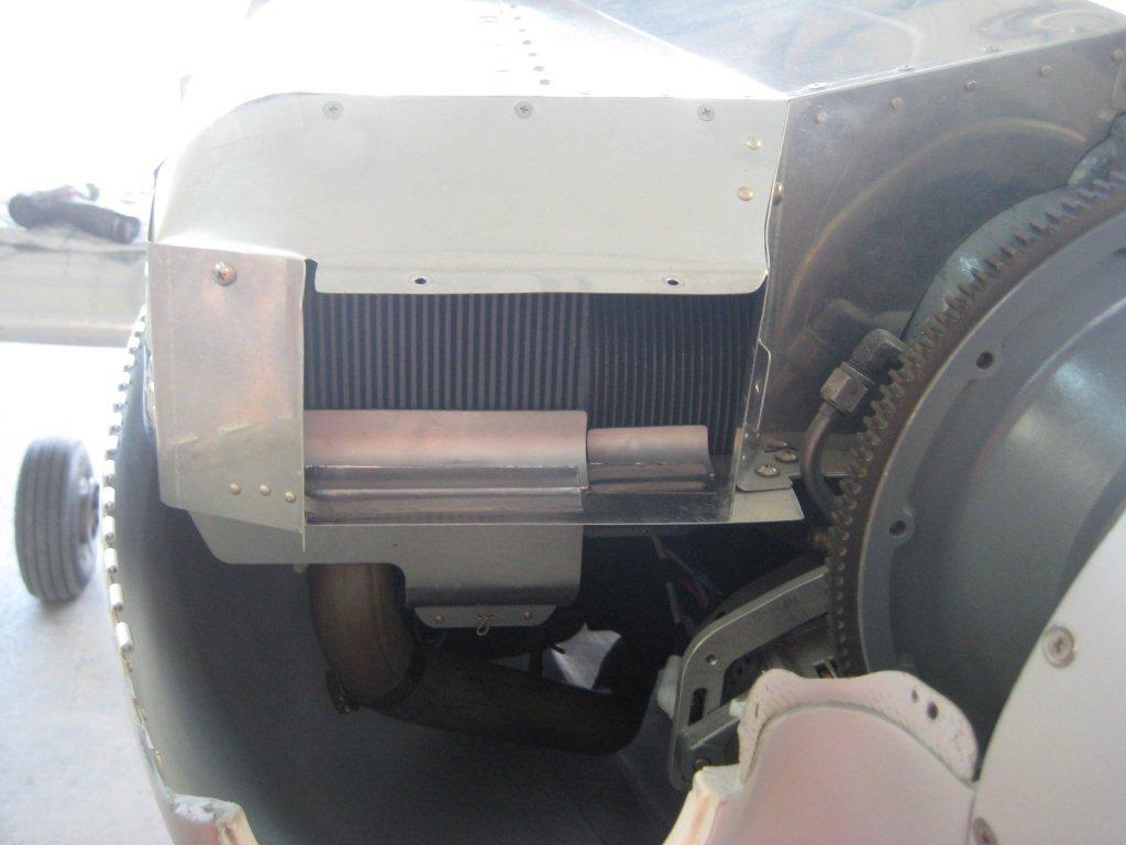

Tape will work to R&D. In fact you can use tape as the dam if you want.
We made curved “ramps” of various sizes to adjust the cooling. What we found is there was very little we could do to bring down #3 temps due to the rear baffle being nearly flush to the backside of #3 preventing any cooling air to run past the rear fins. Other builders have placed washers back there to force a gap for a little batter air circulation. Because I am running a 200 Hp & the SJ cowl cooling is at a premium. We decided to open up the rear baffle and build a ramp for real cooling air to wrap around the backside of #3. This made a 15+ degree difference and also allowed us to remove most of our forward cooling ramps. Note: we were able to make this adjustment w/o removing the baffle.
Robin

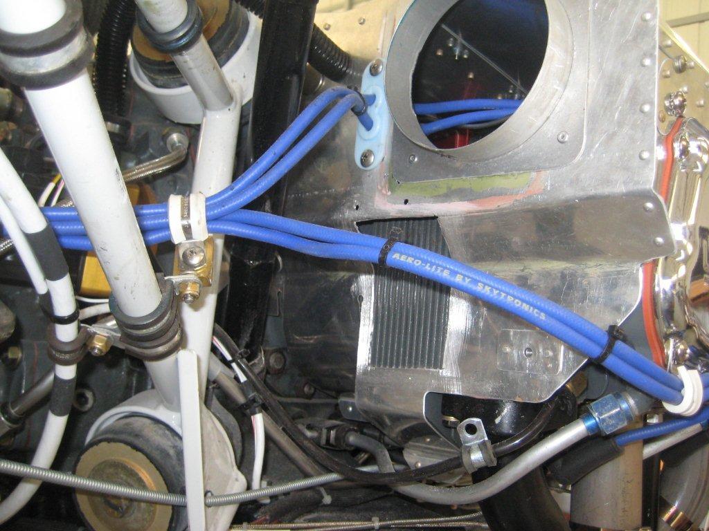

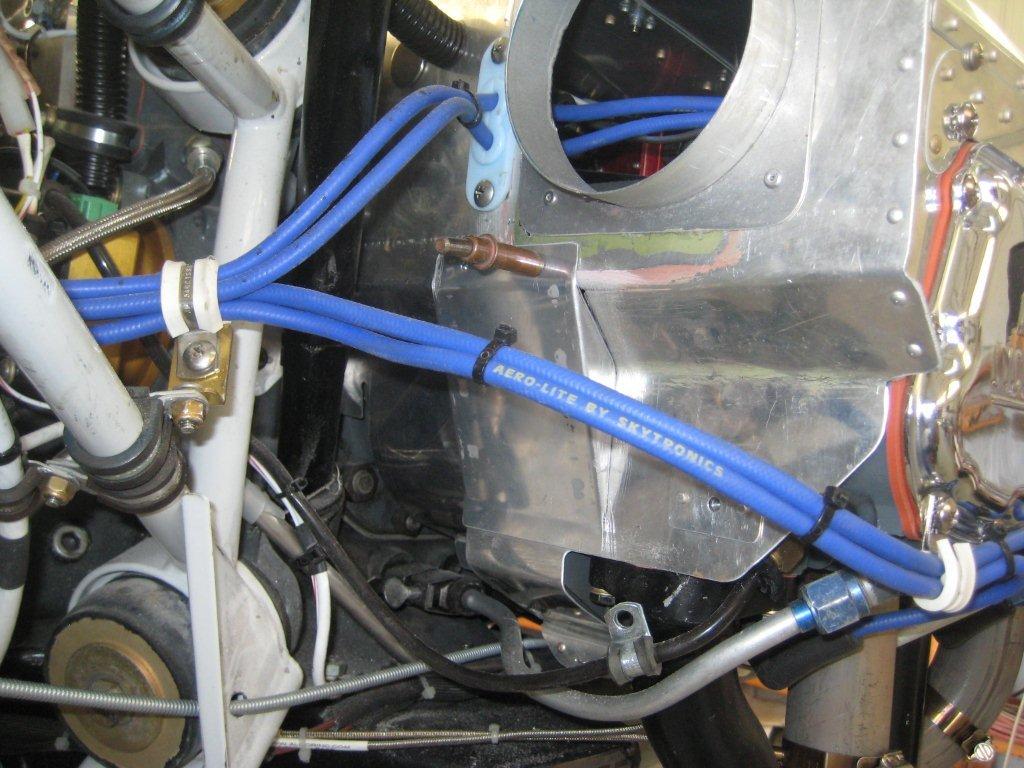

PostPosted: Fri Jul 01, 2011 7:36 am    Post subject: adjusting cooling baffles Reply with quote
Looking at the oil cooler - installed according to plans - I note that the lowest 1 inch of the opening to the oil cooler is directly behind the cooling fins of cyl #4 .  Is air heated by the fins going thru the oil cooler?  Has any one experimented with a small baffle there to block the aft side of the fins on #4 so that the air can't so easily get to the oil cooler there?  I've noticed that once the oil tempo gets high it takes a long time (~10 minutes) to bring it down. Maybe this is why.
I managed to get a 1/16" thick washer on the screw between the rear baffle and cyl #3. It took a fair bit of fiddling, but it's there now.  I will try some tape on #1.

mrobert569(at)hotmail.com
PostPosted: Fri Jul 01, 2011 9:09 am    Post subject: adjusting cooling baffles Reply with quote
What you speak of has merit.  I lower the oil temps over 5 degrees by just adding two layers of baffle rubber material between the oil cooler and the baffle wall.  That effectively moved the oil cooler away from #4 by 1/8 inch allowing much more cool air to get to the oil cooler.

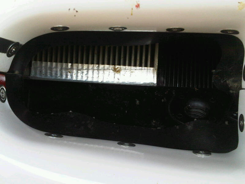

PostPosted: Tue Jul 05, 2011 12:10 pm    Post subject: adjusting cooling baffles Reply with quote
Here is a picture of the "cowl insullation material" stuck to my #1 cylinder. Have 3 degree higher on #3 vs #1 - this weekend at 97F OAT - #3 running at 354F - Oil temp doesn't go over 185F winter or summer.
Doesn't take much tape to affect #3 temps.
