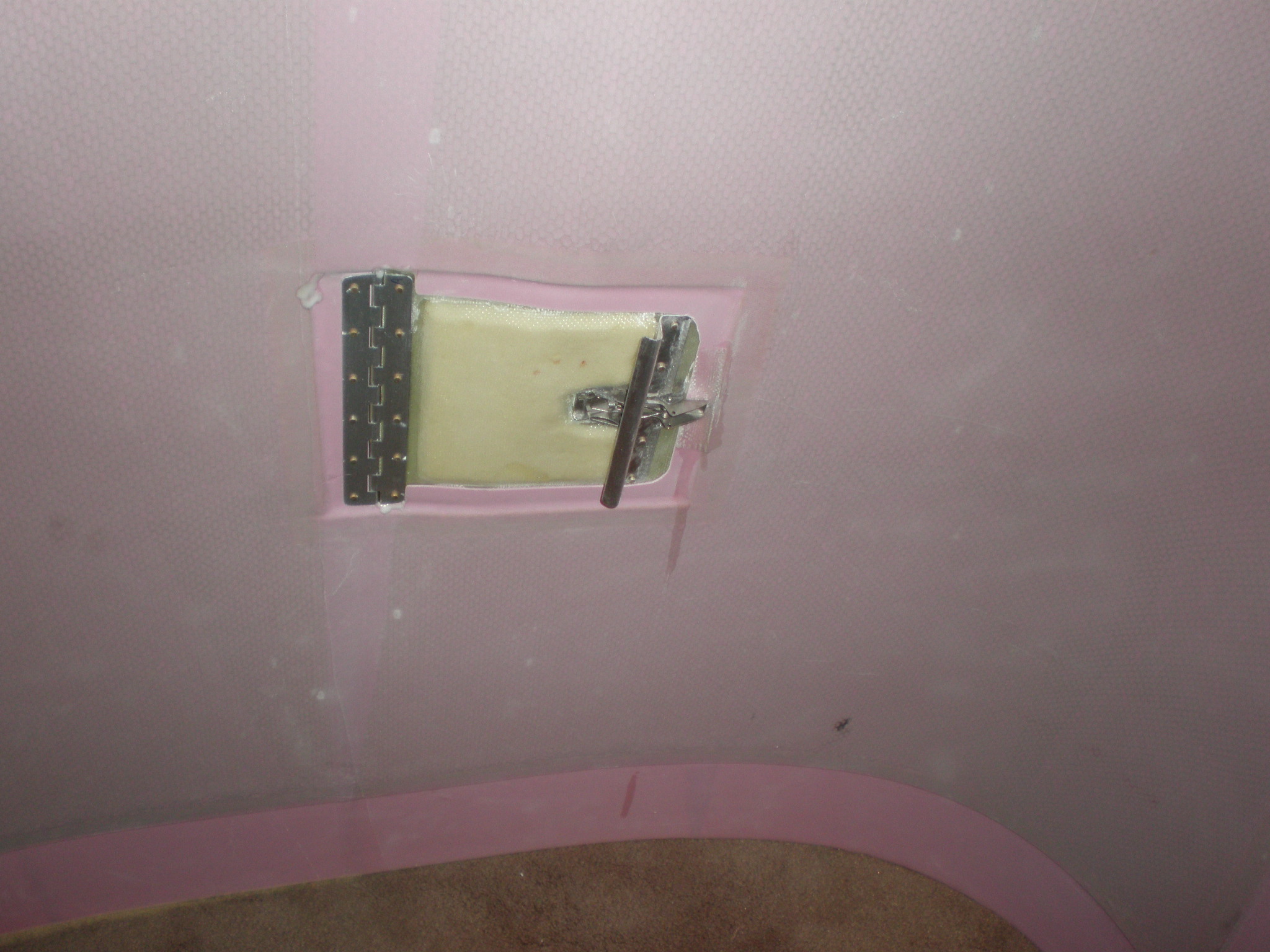

PostPosted: Wed Jun 29, 2011 2:42 pm    Post subject: Hartwell H-5000 oil door fastener Reply with quote
These fasteners are ultra-awesome. I believe that you are correct and that they do come in different offsets. On my oil door, mine there is a slight offset of about 1/8". You need the offset to secure the door to the cowl. You also need to reinforce the outer side of the door to resist the high internal air pressure.

PostPosted: Wed Jun 29, 2011 2:55 pm    Post subject: Hartwell H-5000 oil door fastener Reply with quote
pic of inside of oil door

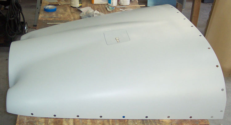

PostPosted: Wed Jun 29, 2011 3:24 pm    Post subject: Hartwell H-5000 oil door fastener Reply with quote
Mine have an offset too. I purchased a 6 pack on ebay and have used them on 2 planes.

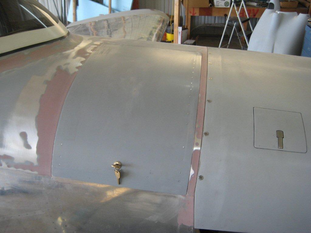

PostPosted: Wed Jun 29, 2011 3:28 pm    Post subject: Hartwell H-5000 oil door fastener Reply with quote
Note: we crafted our own hidden hinge for both the forward baggage door and oil door.
