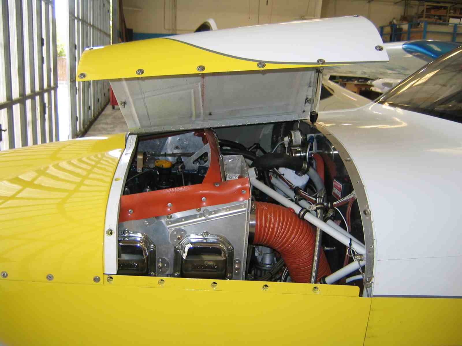

Shameless promotion:
I really like the big oil door we developed. Go to our website if
you're interested.
I think it's pertinent to this discussion since it's just about as
good as taking the top cowl off for inspection. Probably not a lot of
maintenance is going to get done, but being able to preflight the
entire top of the engine and behind the accessory case is comforting
to me.
Also, note how the rear baffle is canted forward at an angle. That
really helps when putting the cowl on (or closing the door) since
normally the seal kind of wants to stand up straight and interfere
with the cowl. This way it just lays down nicely. And notice the
nice orange line from the baffle on the inside of the door. That's
pretty indicative of a good seal.
No temp problems so far. Approaching 900 hours.
Dave Saylor

robin(at)PaintTheWeb.com
PostPosted: Mon Jul 04, 2011 1:33 pm    Post subject: RV-10 Fibreglass Plenum Vs Carbon Fibre Reply with quote
A fellow builder used my hanger for about a week. He installed the
"shameless promotion oil door". Looked nice and practical. I can see
the benefit.
Robin
to me.
Dave Saylor
