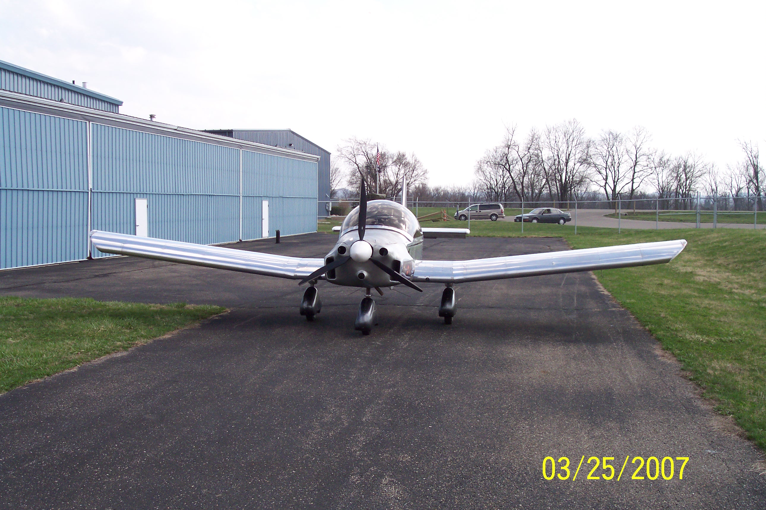

I fly A 601HD with a status Suburu. My engine temperature runs at 190 with an occasional 200 on long hot climbouts. I think that a lot of the problems builders have had with this engine is due to high temperatures. I spent 1 year designing my cooling system and gave a couple of seminars at OSH about cooling systems design. I don't know if that stock design can ever give really good results.My system looks somewhat "radical" and is not easily adapted to a finished aircraft. The problem is that the stock system has no ducting of pressure recover, plus the fact that exhaust and engine heat go into the radiator. Various idea expressed in this forum can help, but the root cause is an inadequate design
