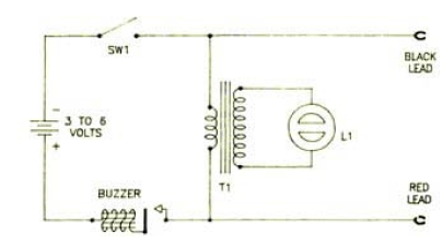

The "magic" behind a magneto timing light is the
device's ability to detect points opening and
closing when paralleled with a VERY low resistance
of a magneto's p-lead winding.
The DC resistance measured with points-open
is low and goes lower when points close . . .
difficult to see with the garden variety
ohmmeter. The legacy mag-timer used a
buzzer to generate an AC signal (not unlike
the Shower-of-Sparks buzzer) to excite
the p-lead circuit.
[img]cid:.0[/img]
When the mag points are closed, there's a dead
short across the primary of the transformer and
no signal is detected by the neon lamp. When the
points open, the dc resistance rises slightly
but the inductive value rises greatly. The small
AC component that appears between the test leads
is amplified by the transformer to a value sufficient
to light the neon lamp. This is the legacy "buzz box".
Additionally, one could generally hear a change in
the characteristic of the sound from the buzzer
when the points open.
