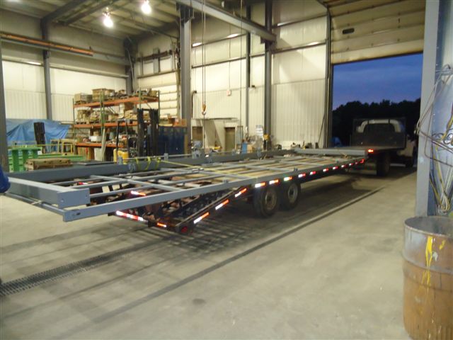

PostPosted: Sat May 14, 2011 5:22 pm    Post subject: Bi-Fold Aircraft Doors Reply with quote

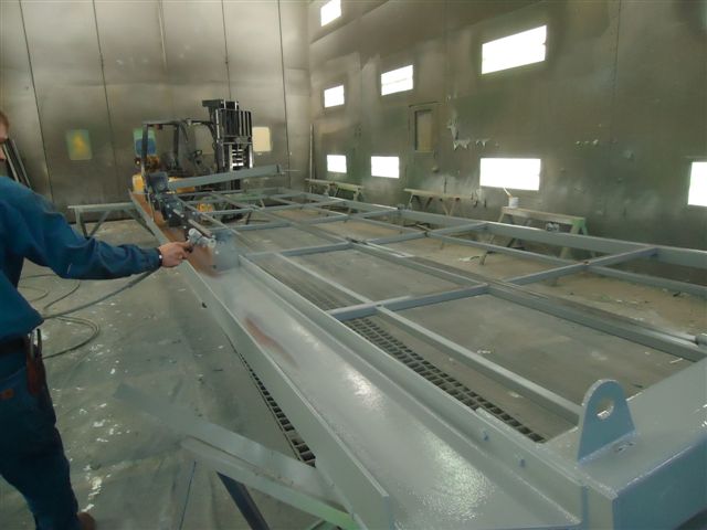

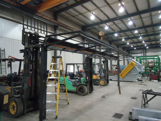

Off to a flying start, but only have the shop on weekends, so I'll post pictures of the finished product soon, for those who are interested.

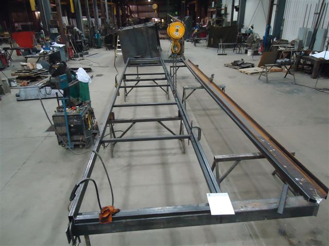

Final Assembly and test today, Works slick ! Paint booth next weekend, then home for installation.

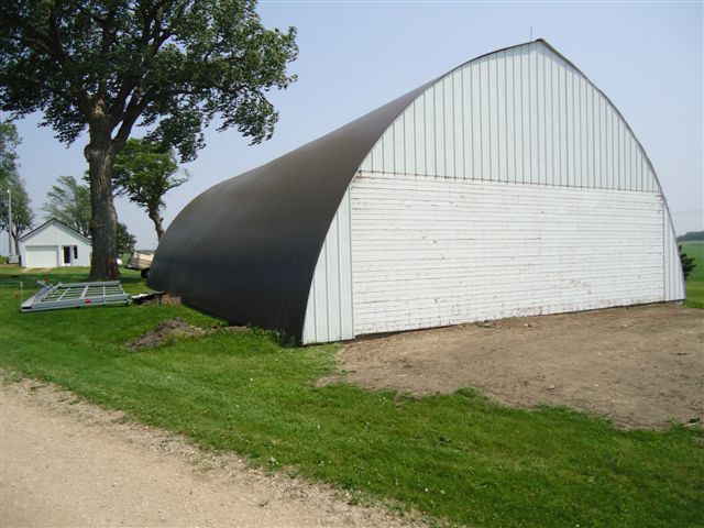

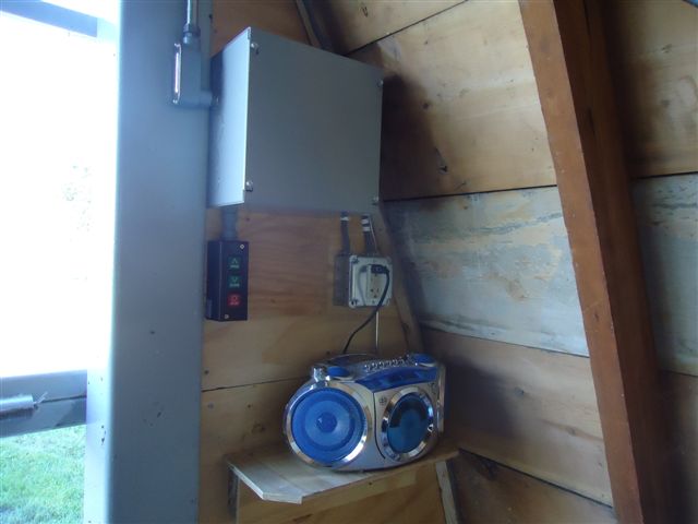

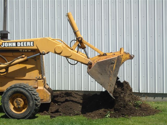

Backfilled the entrance ramp to nearly level, for easy entrance and exiting the Kolb in and out. Purchased a used electric motor and reduction drive unit today also .

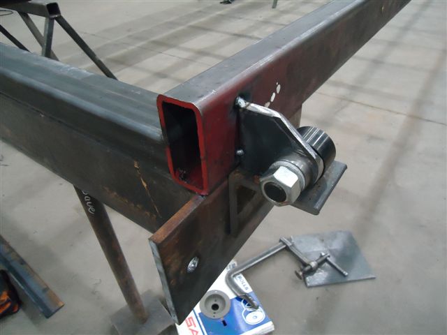

PostPosted: Fri May 20, 2011 12:19 pm    Post subject: Re: Bi-Fold Aircraft Doors Reply with quote

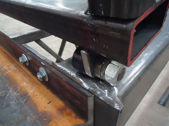

Our Design Details, Before Final Weld
Full Closed Position
Full Up Position

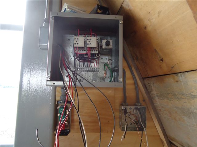

Tomorrow Electric switches and motor with reduction drive unit and drive shaft installed , Then Paint Booth.

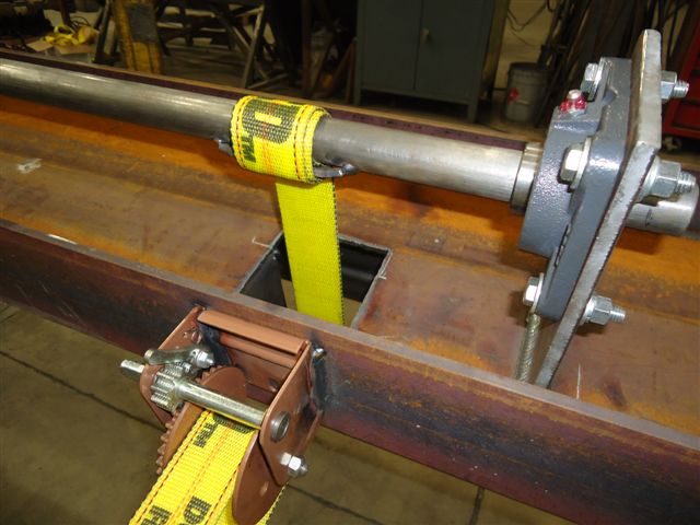

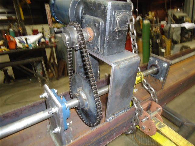

Dennis Thate
Joined: 18 Nov 2010
Posts: 362
PostPosted: Sat May 21, 2011 1:31 pm    Post subject: Re: Bi-Fold Aircraft Doors Reply with quote

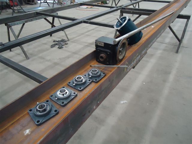

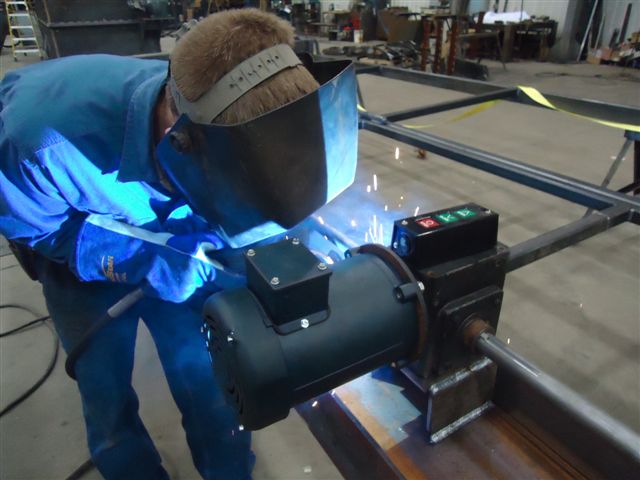

Drive Assembly Installation and more finish welding.
 Filesize:  55.04 KB
 Viewed:  17356 Time(s)
 Filesize:  55 KB

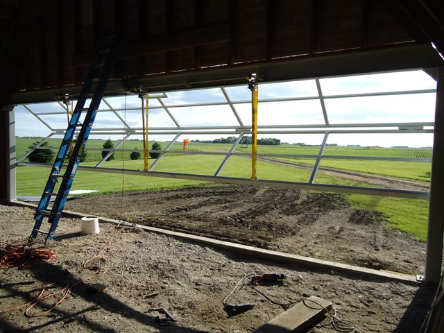

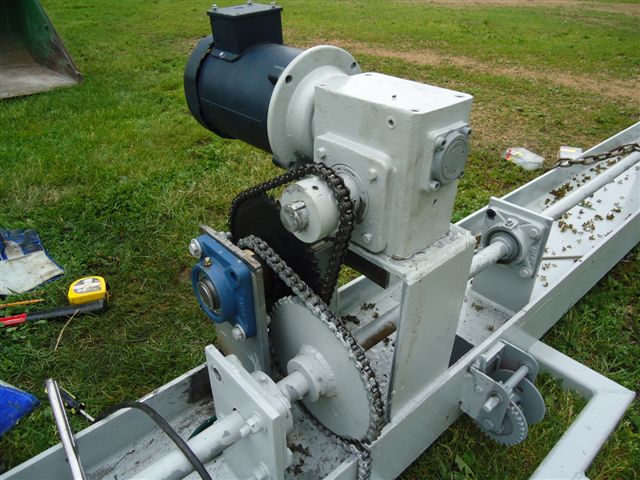

Dennis Thate
Joined: 18 Nov 2010
Posts: 362
PostPosted: Sat May 28, 2011 8:32 pm    Post subject: Re: Bi-Fold Aircraft Doors Reply with quote

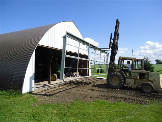

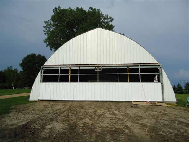

Finally got the beast home....it looks grand, it has the engineering of a Sherman Tank and a heart of a Volkswagen Beetle. Even with a 60 to 1 reduction drive unit plus a 48 tooth sprocket and 20 tooth sprocket the 1/2 horse power single phase electric motor could not handle the 700# door. Only option a larger 3/4 or 1 or 2 horse power motor. ka-ching ! ka-ching! ....it's only money !
Next weekend wall removal and Bi/Fold installation. Stay Tuned !

byoungplumbing(at)gmail.c
PostPosted: Sun May 29, 2011 6:34 am    Post subject: Bi-Fold Aircraft Doors Reply with quote
as the door opener is raising the door.... install some counter weights
that go down, that may eliminate some of the stress. a 1/2 hp does
seem iffy.
boyd
zeprep251(at)aol.com
PostPosted: Sun May 29, 2011 8:06 am    Post subject: Bi-Fold Aircraft Doors Reply with quote
Dennis,
You could try counter-balance weights to reduce power requirements.My bi-fold door is made of 2x4s and corrugated steel sheeting and I open and close it by hand.2 pulleys and cables and 2- 20gal drums of concrete make it move easily.The drums are back in the corners on either side of the tail.Cables attach at the lower corners and center of the door.Pretty straightforward installation. G.Aman

PostPosted: Tue Jun 07, 2011 1:12 pm    Post subject: Re: Bi-Fold Aircraft Doors Reply with quote

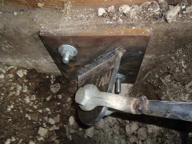

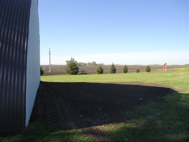

We have been battling high winds and high heat all week. Hope to get the bi/fold installed this weekend....note the trees bending over in the background.

Dennis Thate
Joined: 18 Nov 2010
Posts: 362
PostPosted: Fri Jun 10, 2011 4:30 pm    Post subject: Re: Bi-Fold Aircraft Doors Reply with quote
Everything is ready for installation tomorrow .....Knock on Wood !
Reworked the reduction drive for a third time. ... With the right leverage you can move a mountain. ...
Roof braced for wall removal.
A couple parting shots before it actually turns into a bi/fold aircraft door.
 Filesize:  82.36 KB
 Viewed:  17149 Time(s)
 Filesize:  50.33 KB
Thom Riddle
Posts: 1597
PostPosted: Fri Jun 10, 2011 5:30 pm    Post subject: Re: Bi-Fold Aircraft Doors Reply with quote
That is a three stage reduction! You should be able to do your preflight inspection while the door is opening Smile.

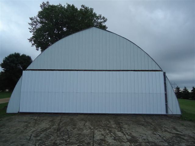

PostPosted: Sat Jun 11, 2011 7:17 pm    Post subject: Re: Bi-Fold Aircraft Doors Reply with quote
*********The three and half minute bifold door ****************
It's been a momentous task, over budget, behind schedule, several redo's. But the end result was well worth all the extra effort. I no longer have to fold the wings on my Kolb Firestar II.
But the frosting on the cake was the real bonding experience with my son. Without his talent, skill and determination I would have never attempted such a daunting task !
Enjoy !

ceengland(at)bellsouth.ne
PostPosted: Sun Jun 12, 2011 4:49 am    Post subject: Bi-Fold Aircraft Doors Reply with quote
But the frosting on the cake was the real bonding experience with my son Ross. Without his talent, skill and determination I would have never attempted such a daunting task !
Enjoy !
Congrats, Dennis; that's a fine looking piece of hardware.

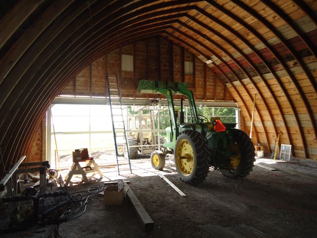

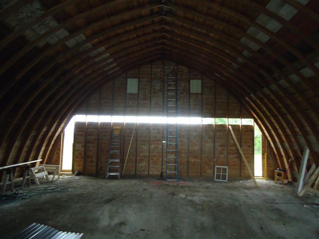

Now, I might be even more interested in the building itself. The
previous shots of the exterior make it look like it might be a pre-fab'd
metal building, but the interior shot seems to show a beautiful wood
truss & decking structure. Was it a kit, or were the curved trusses
built up by someone on-site?
Charlie
Dennis Thate
Joined: 18 Nov 2010
Posts: 362
PostPosted: Sun Jun 12, 2011 4:08 pm    Post subject: Re: Bi-Fold Aircraft Doors Reply with quote
Enjoy !
Charlie
PreFab rafters assembled on Site in 1961. Covered over in metal 5 years ago. Quonset roofs seemed to be the rage back then, but as the walls commonly pushed out and the roofs sagged from years of heavy spring rainfall, the quonset soon fell out of vogue in this region of the country.

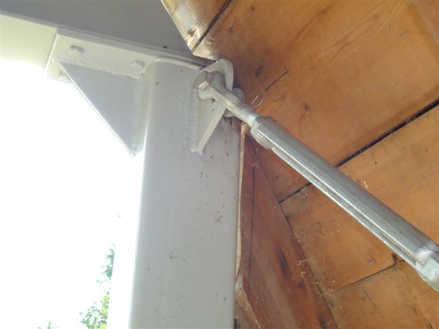

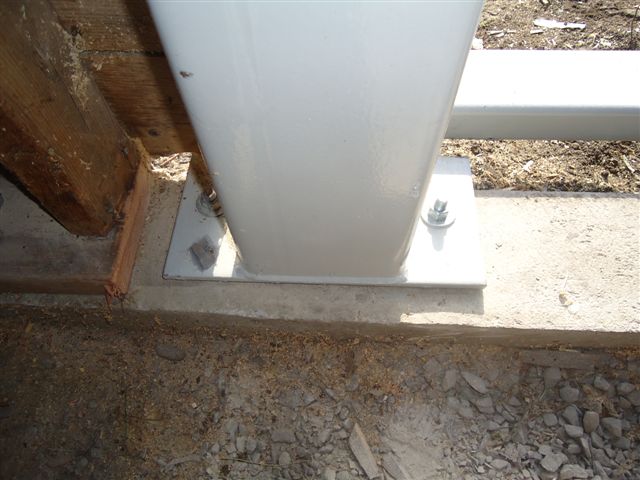

PostPosted: Sun Jun 12, 2011 5:25 pm    Post subject: Re: Bi-Fold Aircraft Doors Reply with quote
Photos of some of the details. Happy to share any of my many photos.
I will post a final shot with the Kolb inside after all the finished work is done and grass is up.
