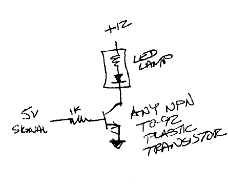

Doesn't need to be a photo-fet. There are plenty of LED
couplers that would work. Is the 5v output measured with
respect to ground . . . and does it go to zero volts
in the off state? Can you turn the bulb on by pulling
its control lead to ground? 28 mA lamp sounds like an
LED, no?
LED, no?
[img]cid:7.1.0.9.0.20110615225649.02041e00(at)aeroelectric.com.1[/img]
OOPS! You said pressure gage? Is this output a linear
voltage that represents pressure or some voltage that is
zero some times and 5v other times?

The the single transistor buffer suggested by myself
and others is a practical solution.

At 12:34 PM 6/16/2011, you wrote:
I'm curious why Daniel recommended a 2.2K resistor and you suggested
a 1K resistor.
Not critical. Throw a dart and anything from 1k to 50K would probably
work.
