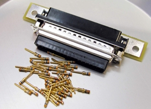

Yeah. Lots if not most avionics get grounded to
the airframe locally because their power and signal
grounds are common to chassis. This is what prompted
the idea behind the avionics panel ground bus added
to the Z-figures along with this product to the catalog.
[img]cid:7.1.0.9.0.20110614102312.01db80f0(at)aeroelectric.com.0[/img]
The idea is to take all the potential victims to
ground in a location as local to the avionics
package as practical. Ground-loops on the panel
are short, and VERY weakly excited. Once the
potential victims are fire-walled, you can
take the power grounds off the panel to about
anywhere free of concerns for installation induced
noise.
This is not so much about holding big
risks for noise at bay as it is doing-the-
best-we-know-how-to-do without jacking up
cost of ownership. The local ground bus
on the panel is a great convenience when
assembling the panel that also goes to
risk of noise reduction.
