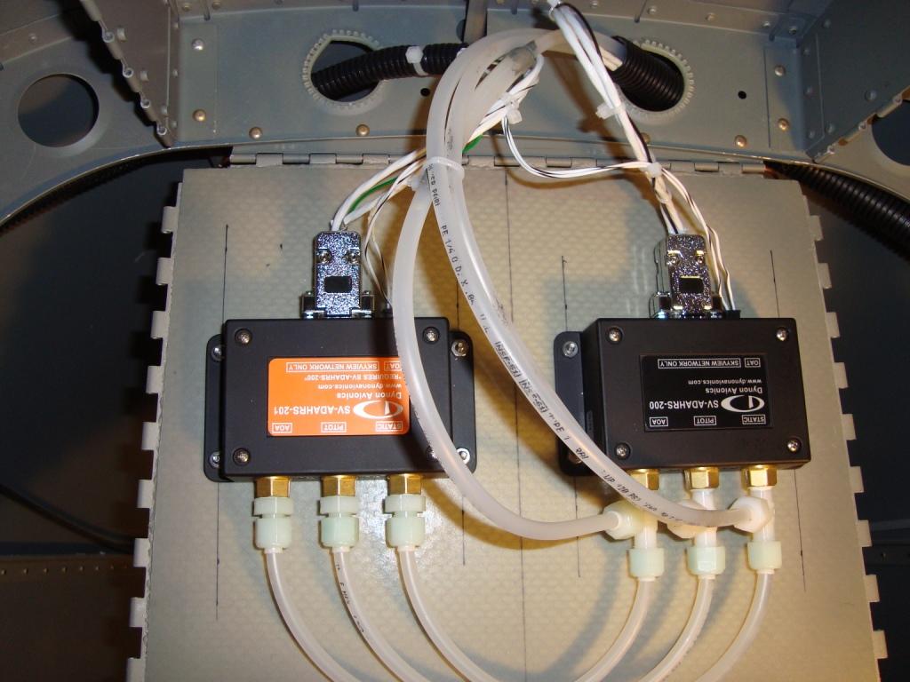

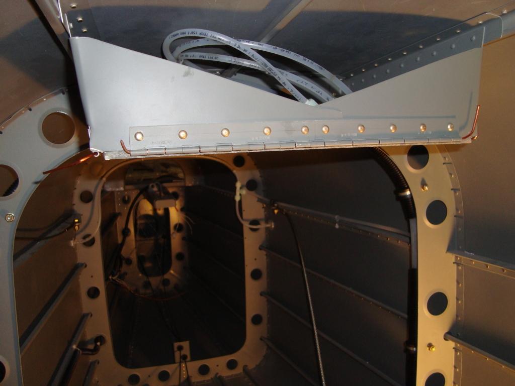

This is what I did.  The bottom of the shelf is made from ¼” fiberglass fiber core board (out of the scrap bin of a Lancair builder).  The hardest part was getting the dimensions of the sides just right so that the shelf was level with the plane axis.  Note the copper wire used for the hinge pins instead of steel pins and the ADHARS mounting hardware is non-magnetic stainless steel.  The shelf is very ridged.  The hinge material makes for easy shelf removal/install.
Carl

Vans sells a kit shelf for ADHARS. It clearly is intended by Vans to be placed alongside the elevator bellcrank behind the battery. I know some (Dynon) ADHARS have incorporated the magnetometer in the same unit, so need a magnetically benign location. Given the steel bolts, etc in the bellcrank, probably not so good a place.
IIRC some have built a shelf near the top of fuselage one bulkhead behind the rear of the baggage compartment. I don't remember who's website I saw this on, but would like to copy it. Can someone give me a link to such a fabrication?
Kelly

Thank you. That is very helpful for ideas.

Kelly, Ivan Kristensens got a real good set of photos on his web site that I intend to use for my build.
