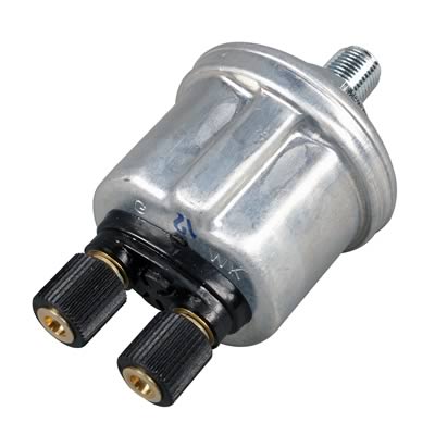

PostPosted: Tue Jun 14, 2011 3:38 pm    Post subject: Oil sensor Reply with quote
"extra ground post"?
Did it look just like the signal post (labeled "G" for gauge) and was there
a "WK" stamped into the metal can next to it? Then it isn't a ground. It is
the "warning contact" for the idiot light and closes to ground when the
pressure is too low.
I've attached a photo of a typical VDO sender with the warning contact.
-- Craig
 Filesize:  16.48 KB
 Viewed:  10180 Time(s)
NYTerminat(at)aol.com
PostPosted: Tue Jun 14, 2011 5:04 pm    Post subject: Oil sensor Reply with quote
Craig you are right , it would be for an idiot light.

[quote]"extra ground post"?
-- Craig

I changes over to the 2 post sender and added a red light in the middle of
the dash to alert me if I ever lost oil pressure. I still have the gauge
running on the other post.
It's nice to have the gauge but you have to keep constantly scanning it for
it to work. I think a red light going on in the middle of the dash would get
my attention much faster.
Bob
