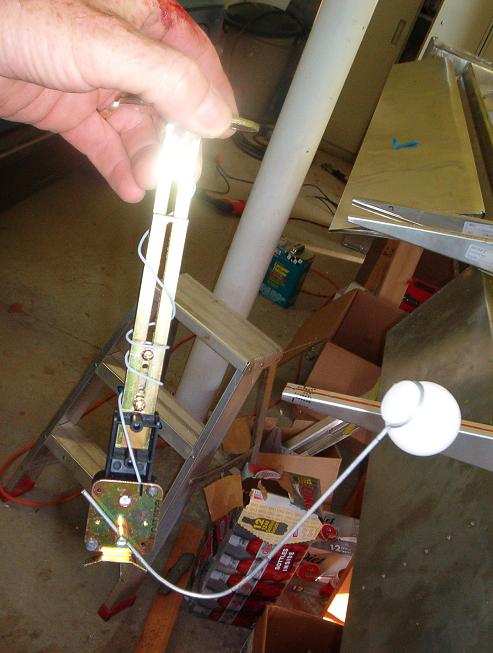

I ran across a couple more questions about the fuel tanks if anyone can help:
The fuel sender float arm needs to be bent. Does anyone have a measurement of how far back from either end it needs to be bent and is is a 90 degree angle? I assume the end that attaches to the sending unit only needs to go into the rotating attachment far enough to catch on the opposite stop?
The fuel sender instructions talk about a back plate and cut-out to get it inn the tank. Is it possible to attach the sender directly to the tank, the metal there has been beefed up and looks like it could handle it. If so, what hardware is recommended for use?
The sender goes from 10-180 ohms. Is the lower resistance for a full or empty tank?

PostPosted: Thu Apr 21, 2011 4:04 am    Post subject: Re: Fuel Tanks Reply with quote
You don't need a back plate for the fuel senders. Just tap the holes and screw it onto the tank. I used something called "sealube" from aircraft spruce on the tank fittings as well as the screws that hold the senders on. It is like a thick paste which does not harden, and is not soluble in gas. As far as the bend for the floats, it is approximately a 90 deg bend but takes a little trial and error to get right. I actually mounted mine with the floats facing back toward the inboard end of the tank to better measure fuel from 1/2 full to empty. Because of the slope of the tank in the wing, putting them the other way will read empty when there is still 4-5 gallons of fuel in the tank. I am attaching a photo of how I bent one of the senders. It is not pretty, but it works.
Steve

PostPosted: Thu Apr 21, 2011 7:53 am    Post subject: Re: Fuel Tanks Reply with quote
Awesome Steve, thanks a lot that helps quite a bit. Looks like your finger got caught somewhere you didn't want it to! Ouch.
Yeah, probably finessing the darn sender in and out of the tank 20 times getting the bend right.
