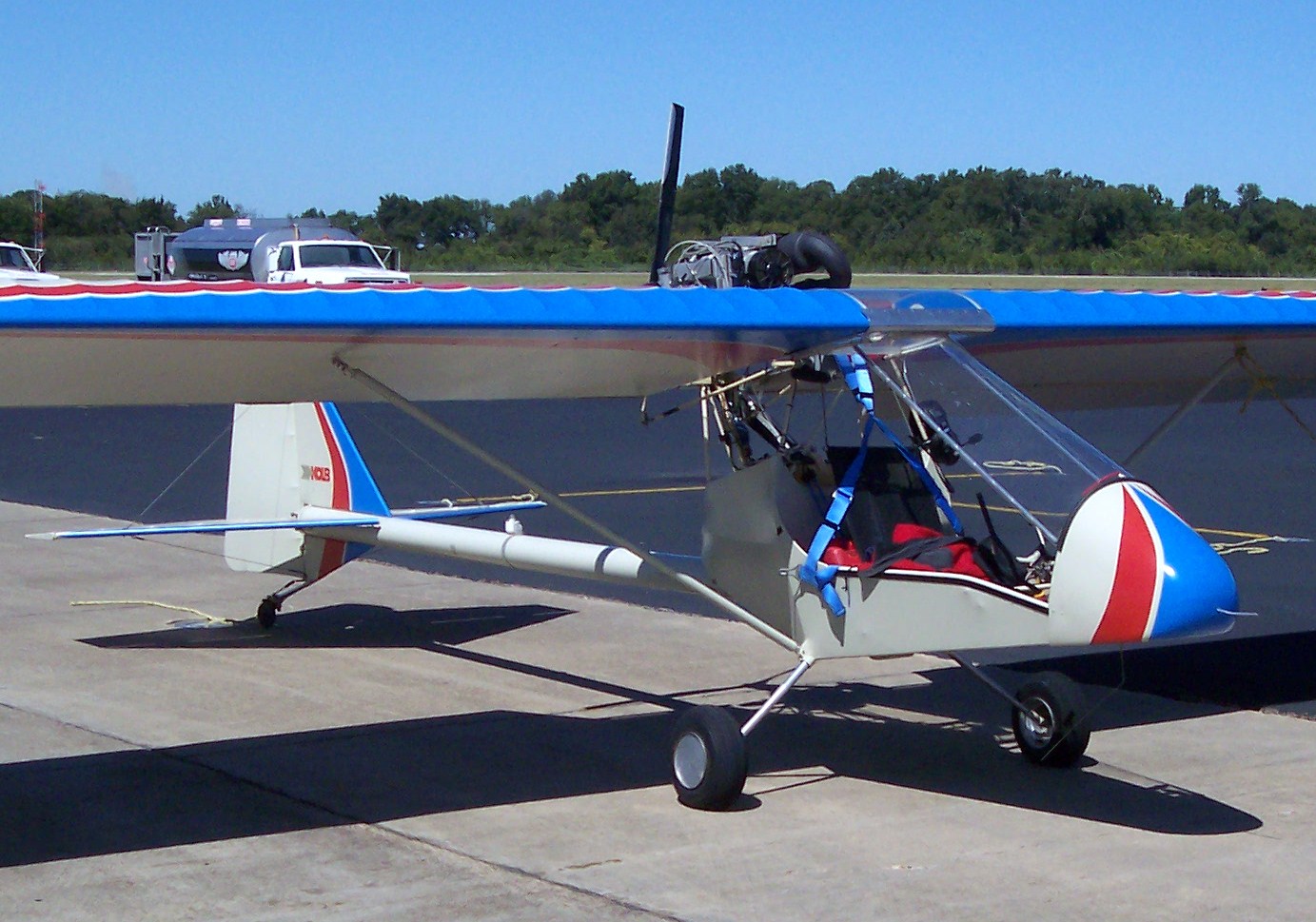

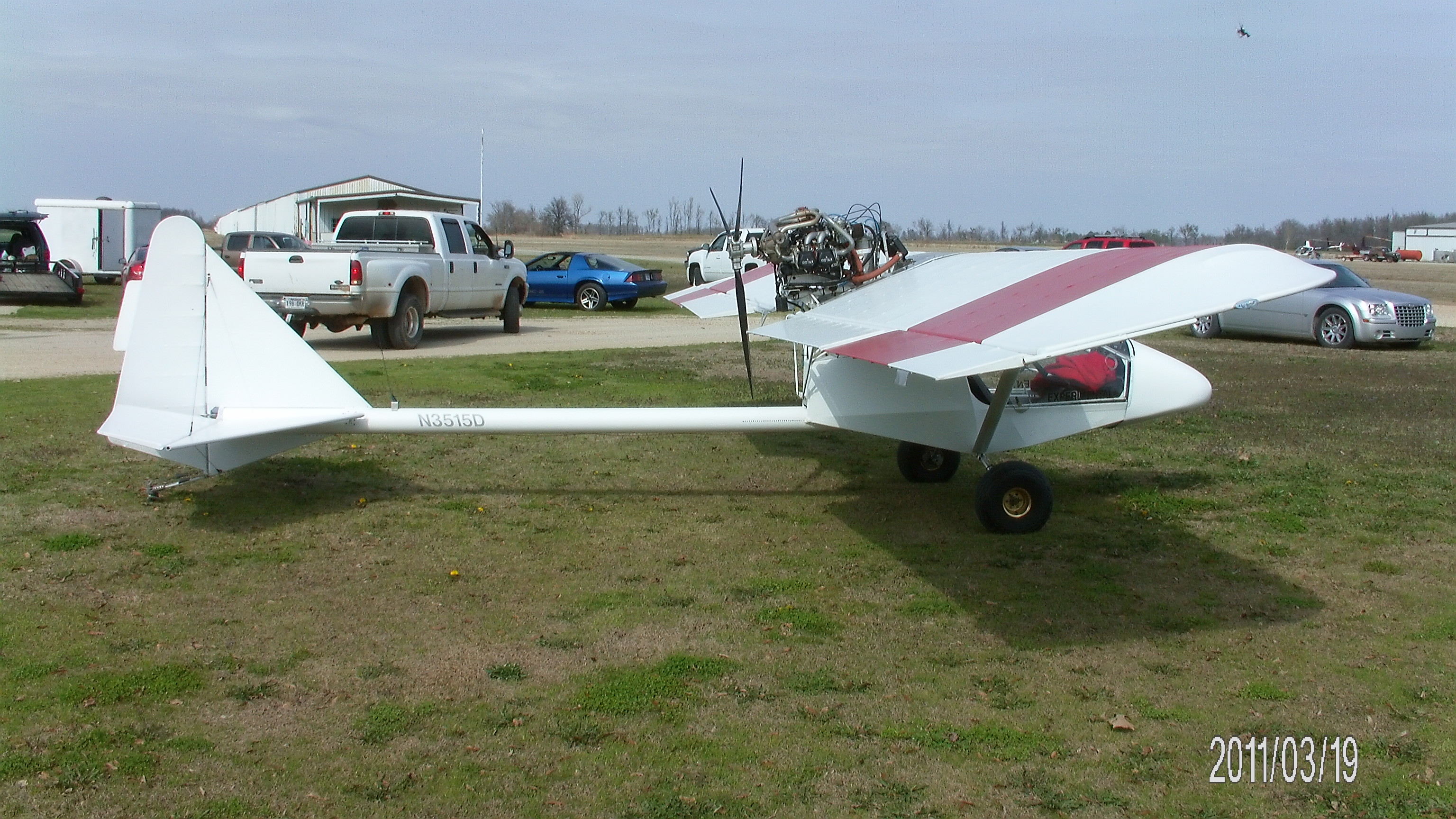

It is getting hot here in the south and I was wondering if anyone has flown their Mark III with the doors off. Any handling issues I might see? Love the open air and visibility of my previous Firestar with no doors. Any Ideas.
Anyone have pictures of what they use to hold the doors up while on the ground? I need to do something fast. I am picturing small lift struts at the front of each door then close the door just before takeoff. Any pictures and details would be appreciated. I'm sure there are plenty of you who have something that works for you.
