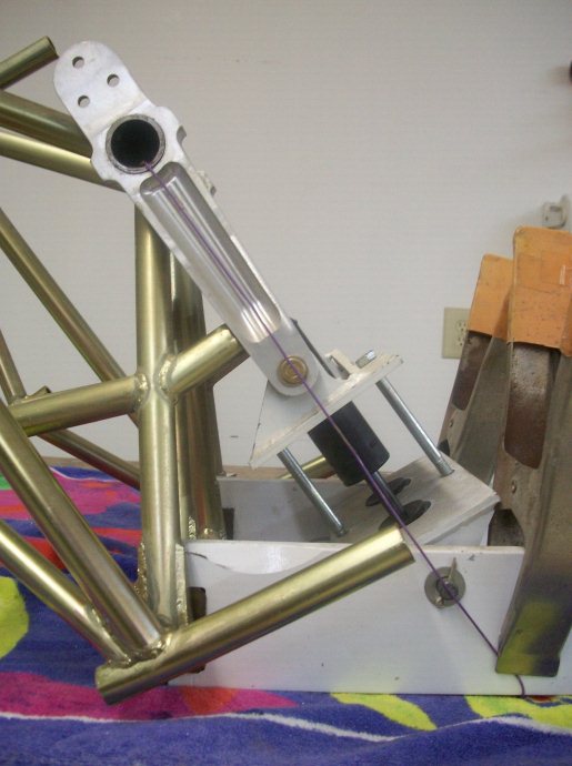

[url=http://photos.msn.com/Viewing/Album.aspx?PST=8nK2AN1B!1LEiKSdooxx9v4CFFiF2tnPzfqiCRx5lZJ3t2ol6z9!Q9u31z2Gf34UKChg6aSaSkGODYJ1SdylXQ%24%24][img]cid:007301cc293d$6886a460(at)adminPC[/img][/url]
Note that the wire line shows the center pivot at the pin through the lower LG08 arm is just forward of vertical. Typically just about 1mm when everything is bench fitted.

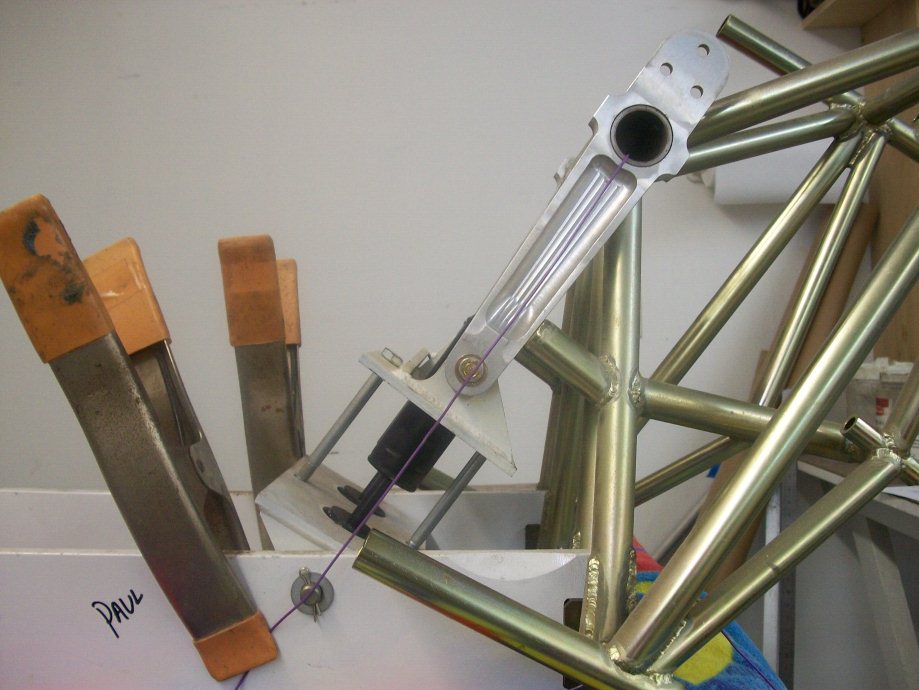

[url=http://photos.msn.com/Viewing/Album.aspx?PST=8nK2AN1B!1LEiKSdooxx9v4CFFiF2tnPzfqiCRx5lZJ3t2ol6z9!Q9u31z2Gf34UKChg6aSaSkE!zuM!0*scuA%24%24][img]cid:007401cc293d$6886a460(at)adminPC[/img][/url]
I rigged this arm without bearings in the LG09 to show what a stop that was too long would look like. Note that if the main swing arm was put under pressure the gear would collapse.
In the the past some discussions were made that the gear leg stops on the frame were too long (as shown in the photo above) and the gear mechanism was not vertical. In this case the stops needed to be ground down.

  • Next I make sure that during gear installation (Chapter 29M) the gear handle and swing arm geometry assures that the LG 08 and shock arm assembly is just forward of vertical on both arms a slight amount (1mm at the joint). To do this I insert a #20 wire or similar through the LG 08/09 and pull it down to the center of the main swing arm 1/4 inch pin LG 04. Simply look up and check the MS 20392-5 pin is slightly forward of vertical. Finally, check that the gear handle is secure in holding the LG08 affixed to the stop, and you are good to go.
  • Finally, since the LG 08s are fixed together by us amatuers, one arm may be lazy about hitting the stop, especially if the flap is dragging or the rubber block shock mount is loose or worn or was installed twisted slightly (really hard since it is a welded structure but it probably could). So be really anal about this installation getting the arms straight and the pins installed well.
Most of us are relieved and gratified when we put the gear handle down, a distinct snap to the down position is made during retraction/extension tests. The bungee amplifies the sound of the slight over center and normally you cannot even get a feeler gauge between the LG08 and stop when extended. Further, in a well built gear system, the gear handle drops itself into the lock slot and the safety catch drops in on its own. That is the test of the gear down lock, when the gear handle is taken from the up lock position, and it drops itself and slams firmly into the lock position.
Finally, if the gear over center locks are filed so they are grossly over center, this is a major problem. If too far forward, the gear handle geometry is going to be off. The gear handle will work against the bungee to spring the gear from its over center then up and the motion of the gear handle travel will be longer than normal. It also will allow the rubber block and shock when compressed and released to act as a spring and pull so hard on the LG 08 that if the gear handle has any sloppiness in it, then it is possible, if the frequency of the gear shock/block and the landing surface were just right, the LG08 may be snapped from its contact with the uplock back to vertical, or worse yet, rebound to slightly over center aft to the unlock side and become unlocked. This condition is seen as an unintentional gear retraction with bent handle as in Jeff's excellent pictures.

Just to make sure everyone knows that under center is a bad thing, your second picture clearly shows that the LG08 is under center which is exactly what you don't want. The first picture looks OK.
Instead of using a string, I turned a pin that fits into the large shaft of LG08 and has a portion turned the same diameter as the other two pins. Now in situation can check with a straight edge

<?xml:namespace prefix="v" /><?xml:namespace prefix="o" /><![endif]--> Yes, picture two, on the good bad scale, is bad.
I have used a straight edge also. The custom pins are a bit over the top, but useful as sometimes the cradle structure gets in the way of seeing just how close it is to over center aft where a collapse can happen....
