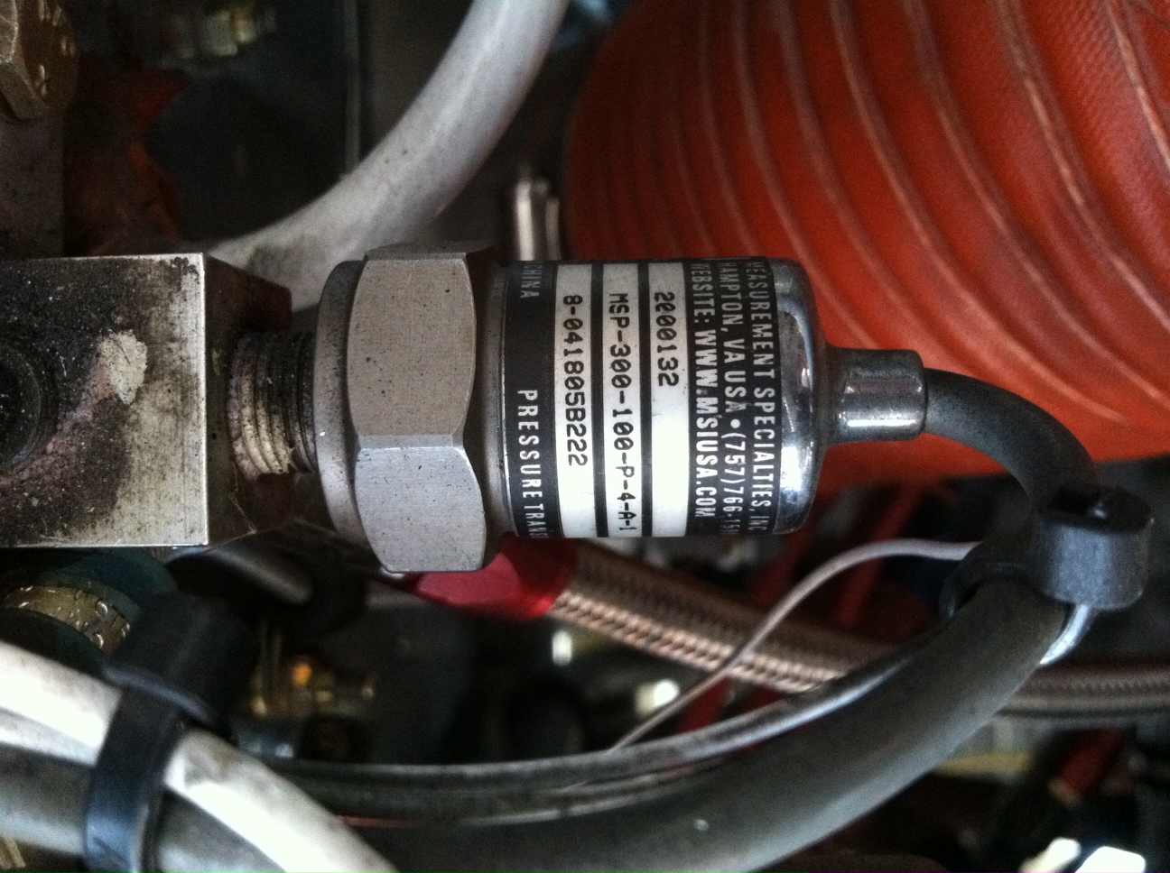

Before I was even flying and while I bought my stuff, I had asked GRT if what I was buying was the best I can do on stuff. They said that many Lancair folks buy this fuel pressure sender instead of the standard one they supply. Knowing that most Lancair builders don't care about $10 or $20 upcharges, as I don't either, if it gives better quality, I purchased this sender. It's been flawless for 725+ hours. The oil pressure sender is their standard one and has also been flawless.
You might want to just get the better sender if you have problems. See attached:
P/n: 2000132
Model: MSP-300-100-P-4-A-1

I bought the same sender from the beginning.
I would also recommend the higher end EGT probes.
-Scott

Ditto...as Scott says, ask them (GRT) for the Hastelloy EGT
probes if you ever change EGT probes.
