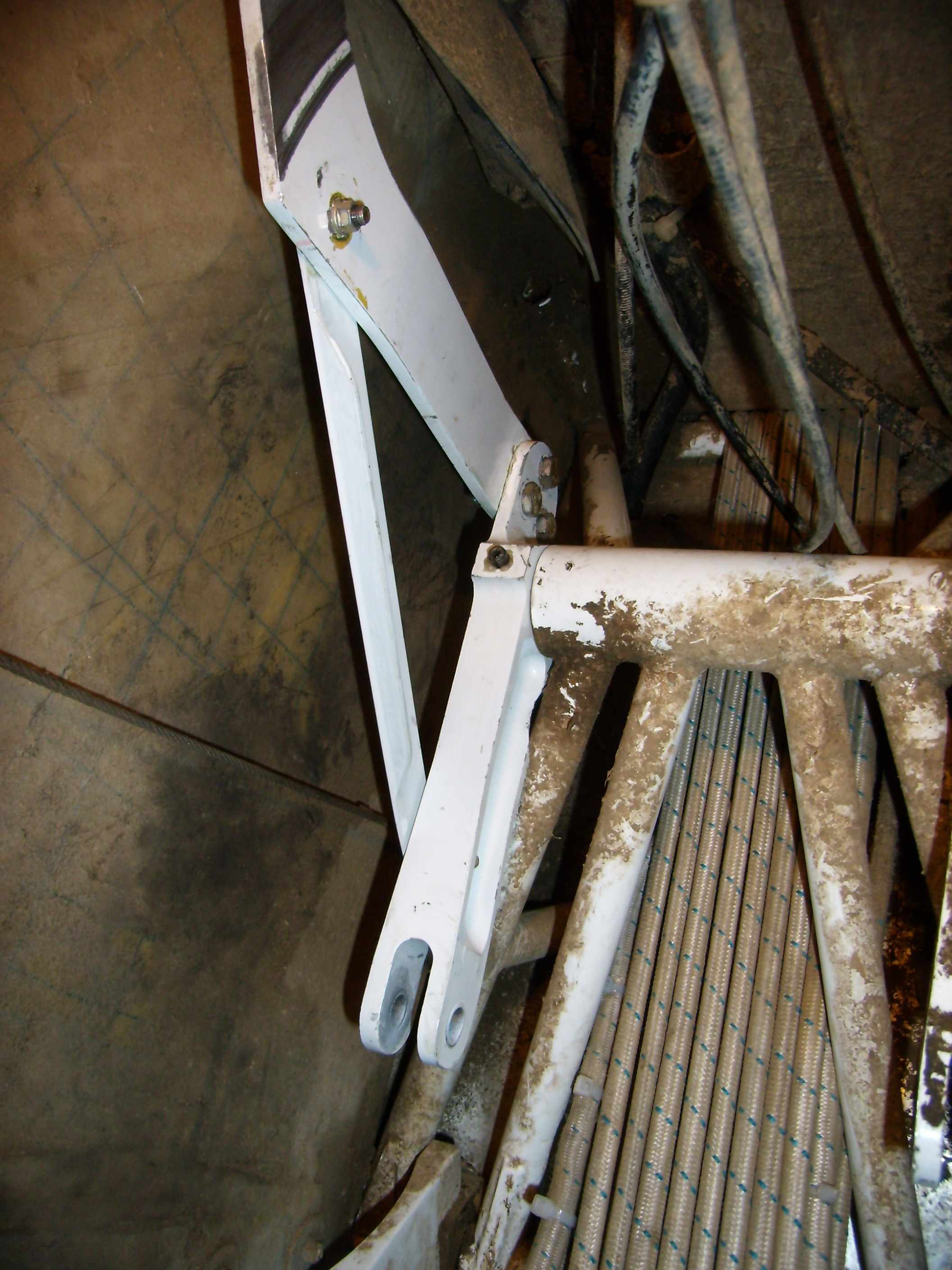

PostPosted: Sat Jun 04, 2011 12:34 am    Post subject: N127ZP Landing gear failure. Reply with quote
Hi All
Looking at the pictures the slot for the retract lever looks very wide.
Mine is just wide enough to let the lever slide easily. It is noticeable
that the gear has collapsed because the lever has twisted and deformed.
Is there a connection?
Pete

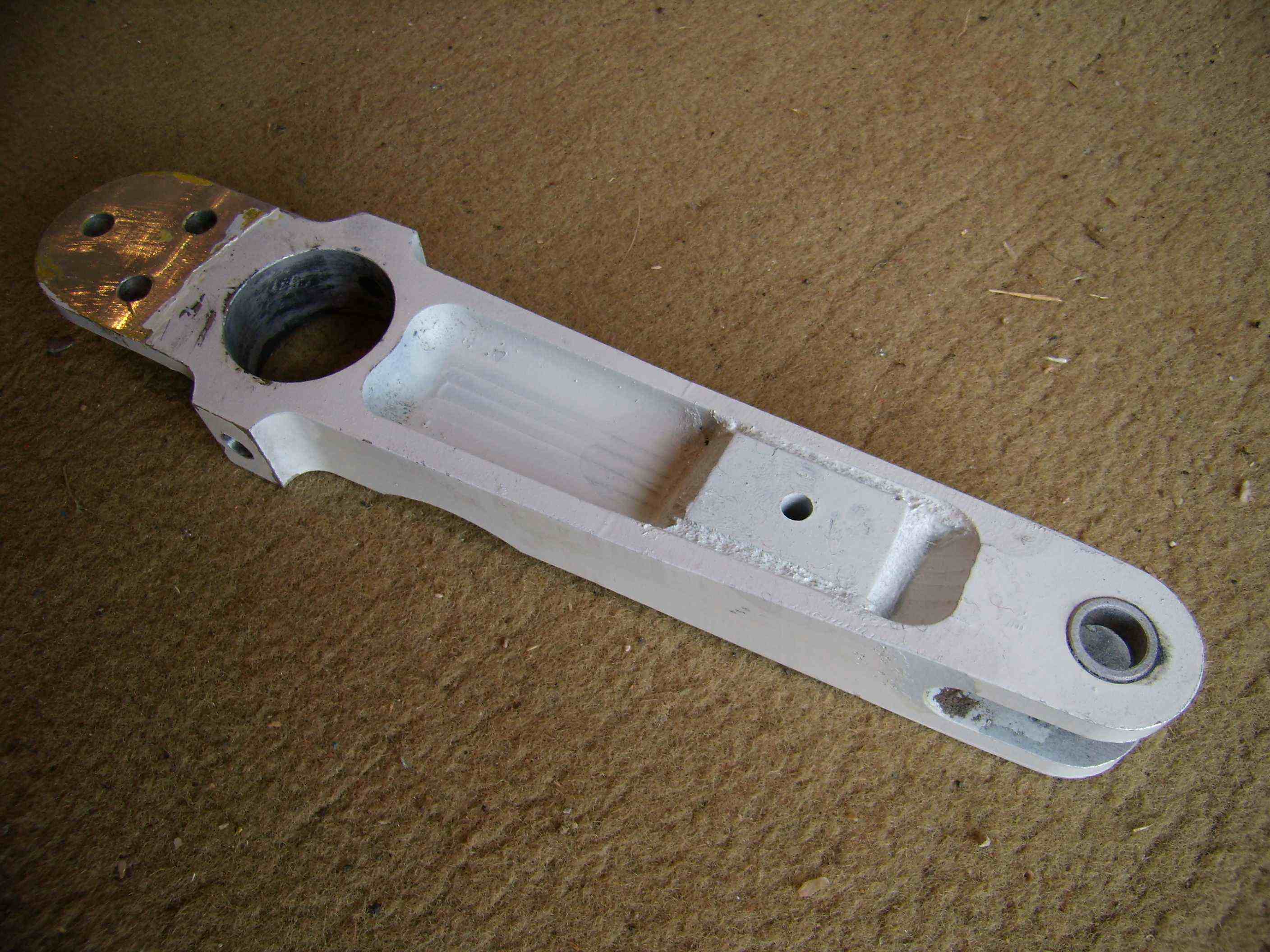

PostPosted: Sat Jun 04, 2011 7:26 am    Post subject: Re: N127ZP Landing gear failure. Reply with quote
Hi Jeff
When working on my XS gear of A265, I made a jig and fixture to
observe and allow myself to fully understand how the gear worked.
I was able to make a measuring jig and to my horror my undercarriage
mounting frame was allowing one side to be on center, and the other under center.
I believe there is a good chance this is a recipe for the disaster you and Ken experienced.
You want both sides over center by at least 1/16".
There is no mention in the manual of checking this or just how important it is to be over center, but keep in mind not too much over center or you can bend components on the under carriage mounting frame.
BTW on early Classic undercarriage mounting frames there was a mod to add more steel and melt it in place. I forget the number of the mod or bulletin.
I urged Steve D. to check his, and his needed attention as well.
I ended up lopped off the stops to allow about 1/8" overcenter, then Reduxed in place a nice piece of hard durometer polyurethane obtained from McMaster in addition to using a #3 bolt to hold the slug of Polyurethane in place. The Polyurethane allows for a small amount of shock absorption, but even if it were to fail, only 1/8" overcenter could be achieved.
it's been a while and I forget exactly how i made my measuring tool, but going from memory now, I made something that went inside the LG08 large diameter pivot that had a pin central located the same diameter as the pin at the base of LG08, which is also the same diameter as the pin (LG04) that the bottom shock absorber plate pivots on.
Anyway you have now 3 pins the same diameter. using a thin steel rule you can measure to see if they are absolute in alignment (which would mean they are on center) or if the bottom LG08 pin is a bit forward (over center) like you want.
Here arew some drawings:
http://www.europa-aircraft.biz/upload/cmb_29m_landinggear_mono.pdf
BTW to save yourself at a remote airport or if you need to get off
runway quick, John Hurst mentioned you could remove right stabilator, remove right wing, take seat cushions on put under fuse, and roll plane on right side, pull gear down, get stuck and then roll your bird off the runway.
Good luck.
Ron P.
BTW looks like Jab, not Rotax, not sure procedure on Jab for prop strike.

It is critical that the retraction system is over center against the stops of the frame and remain in this position all the time the gear is down. The factory has improved the original design with the addition of the strut (Mod 51). But the lower end of this strut being attached to a pin and fork assembly, there is inevitably a play which develops there overtime which makes the mod less effective, possibly allowing LG08 arms to move away from the stops. I designed a variation of Mod 51 which eliminates this defect. See attached pictures. The port LG08 arm is modified with the installation of an aluminum plate glued with epoxy and flox. The lower end of the strut is bolted directly on LG08 with an AN3 bolt. Therefore there is no possible play in the LG08/LG12/strut assembly.
Remi Guerner

Hi, I was very sorry to read of your misfortune. It must be heartbreaking. With luck the damage to your lovely looking plane will be just the retract handle, strut mod and a new guide plate. (Engines and props are just bolt on accessories!!)
Just a few thoughts from me: As the retract handle is still in the "down gate" the over-centre locking mechanism has obviously failed to do it's job and has let go for whatever reason. Certainly this should not be able to happen so I feel it must be considered that something was not quite right with your set up. It may or may not be possible to determine now what it was but either way I'm sure that when you repair and check things it will definitely be possible to avoid it happening again.
I believe that during the initial build (and in the uk, at each annual inspection) there are two critical considerations:
1/ The geometry of the set up must be correct.
2/ There must be no wear or play in any of the system which might allow this otherwise correct geometry to alter.
Nb. The following must be finally checked with no weight on the wheel, ie. aircraft hoisted.
1/ Geometry:
(a) The LG8 arms must contact their respective stops together and be parallel to each other. Furthermore when the arms are on their stops the front edge of the retract lever must be hard against the front edge of the "down gate" on which it reacts. The lever holds the arms against their stops so there must be no gap here whatsoever, just a tight sliding fit so that you can actually move the lever laterally in and out of the gate. If there were to be any gap here then any vibration in the system could cause the lever to move forward slightly thus partially retracting the undercarriage and bringing the "over-centreness" of the lock to a critical point where it might go past the point of no return and collapse. If it was to go past that point with the weight of the aircraft on the wheel then nothing will save it!
(b) Furthermore, with the gear down and locked, the amount of over-centre must be checked to be correct. An accurate method of sighting up (the centres) must be devised. The middle pivot point (top reaction plate clevis pins) must be min 1/16'' and max 1/8'' forward of the top pivot point (LG8 mounting shaft) and bottom pivot point (LG04 pin). Too much puts extra strain on the LG frame, too little and the over-centre lock would be critically ''weak'. To achieve this the LG8 stops must be the correct length. They ''should'' be correct from manufacture but I have heard of some people having to grind them down a bit and/ or adding to the length to get the amount of over-centre spot on. Finally the pre-tension of the rubber block must be set correctly to achieve the correct result (79mm between inner faces of the top and bottom reaction plates).
2/ Wear: Any wear or play anywhere in the system could cause movement which might critically affect the geometry, possibly allowing the over-centre to become critical and collapse.
Namely, wear in any of the pivot points and bushes, wear/ slop developing in the joint between the retraction handle and the port LG8 allowing unwanted movement of the handle relative to the gear (though I notice you have the strut mod so this should have been ok.) etc.
Could it possibly have been that on yours you may have had some gap at the front of the gear handle, or maybe the LG8 stops were slightly too long thus not giving a safe amount of over-centre? These seem to me to be the most likely causes.

PostPosted: Fri Jun 10, 2011 1:36 pm    Post subject: N127ZP Landing gear failure. Reply with quote
The retraction lever should be taking no load when the u/c is extended but
merely hold the mechanism in the over centre position. From the pictures it
would seem that a great load has been put on the retraction lever indicating
that the mechanism was not in the over centre position when the lever was in
the down and locked detent. This is something that should be carefully
checked during set up and during servicing checks. I am very sorry for Jeff
as it looks a lovely aircraft but it should be quite easy to repair.

The retraction lever should be taking no load when the u/c is extended but merely hold the mechanism in the over centre position. From the pictures it would seem that a great load has been put on the retraction lever indicating that the mechanism was not in the over centre position when the lever was in the down and locked detent. This is something that should be carefully checked during set up and during servicing checks. I am very sorry for Jeff as it looks a lovely aircraft but it should be quite easy to repair. Remember to send me some pictures for the Europa Flyer when she is flying again
Tony
